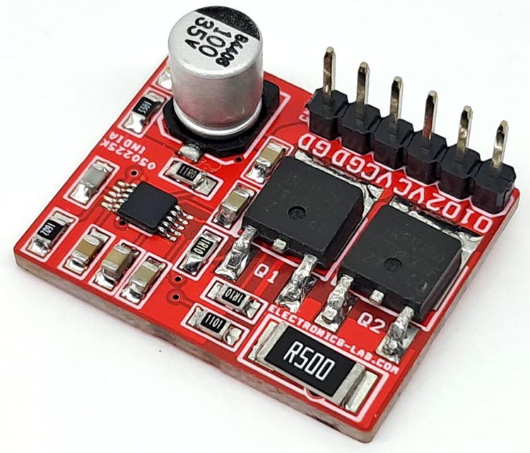

This project is a simple, low-voltage push-pull PWM controller using the TI LM5032 chip and two MOSFETs. It's suitable for applications like DC-DC converters or Tesla coil drivers. Frequency, current sensing, and soft start are configured via external components.
Push-pull voltage mode PWM controller

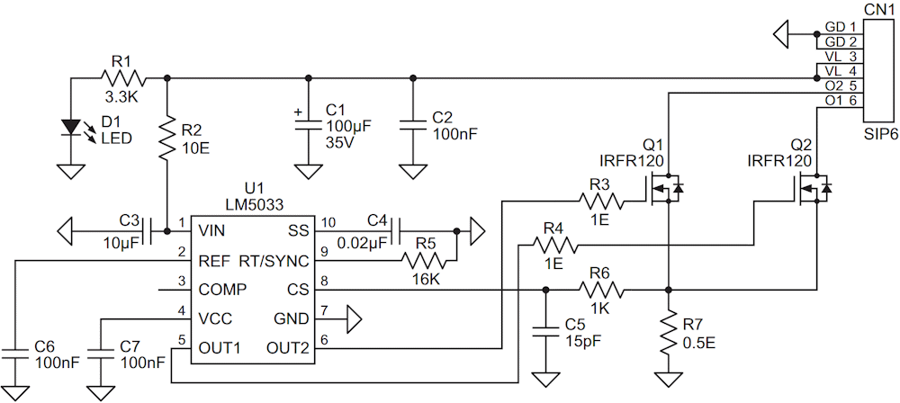

This is a simple low voltage push-pull voltage mode PWM controller based on LM5032 chip from TI (Figure 1). The board is build around LM5032 chip and two 100 V 7 A MOSFETs. It can be used in simple DC-DC converter, Tesla coil driver etc. The frequency can be changed with resistor R5. Resistor R7 play roll of current sense. Capacitor C4 configures the soft start function. Output is square wave open drain.
Schematic diagram of a PWM controller.
Figure 1. Schematic diagram of a PWM controller.
Frequency selection
  • R5 16K = frequency 339 kHz
  • R5 8.2K = frequency 600 kHz
  • R5 26.7K = frequency 200 kHz
Features
  • Power supply 15 V to 30 V DC
  • Maximum load 1 A (MOSFET 7 A)
  • Operating frequency 339 kHz
  • Thermal shutdown
  • Over current protection 1 A
  • PCB dimensions 27.31 × 21.75 mm

Figure 2 shows the controller connection diagram.
The PWM controller connection diagram.
Figure 2. The PWM controller connection diagram.

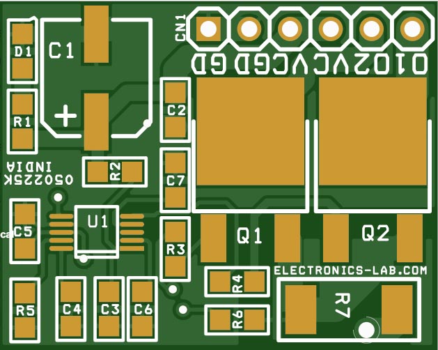

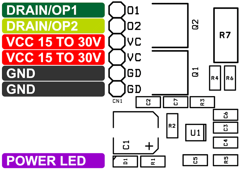

The Gerber project files can be downloaded from the link in the Downloads section. The PCB layout is shown in Figure 3. Table 1 shows the bill of materials.

Designator Description Package/
Footprint
CN1 6 pin male header Pitch 2.54 mm
C1 100 µF/35 V electrolytic
C2, C6, C7 100 nF/50 V ceramic 0805
C3 10 µF/50 V ceramic 0805
C4 0.02 µF/50 V ceramic 0805
C5 15 pF/50 V ceramic 0805
D1 LED red 0805
Q1, Q2 IRFR120 DPAK
R1 3.3 kΩ 5% 0805
R2 10 Ω 5% 0805
R3, R4 1 Ω 5% 0805
R5 16 kΩ 1% 0805
R6 1 kΩ 5% 0805
R7 0.5 Ω /1 W 1% 2512
U1 LM5033 VSSOP-10
The PCB layout.
Figure 3. The PCB layout.
