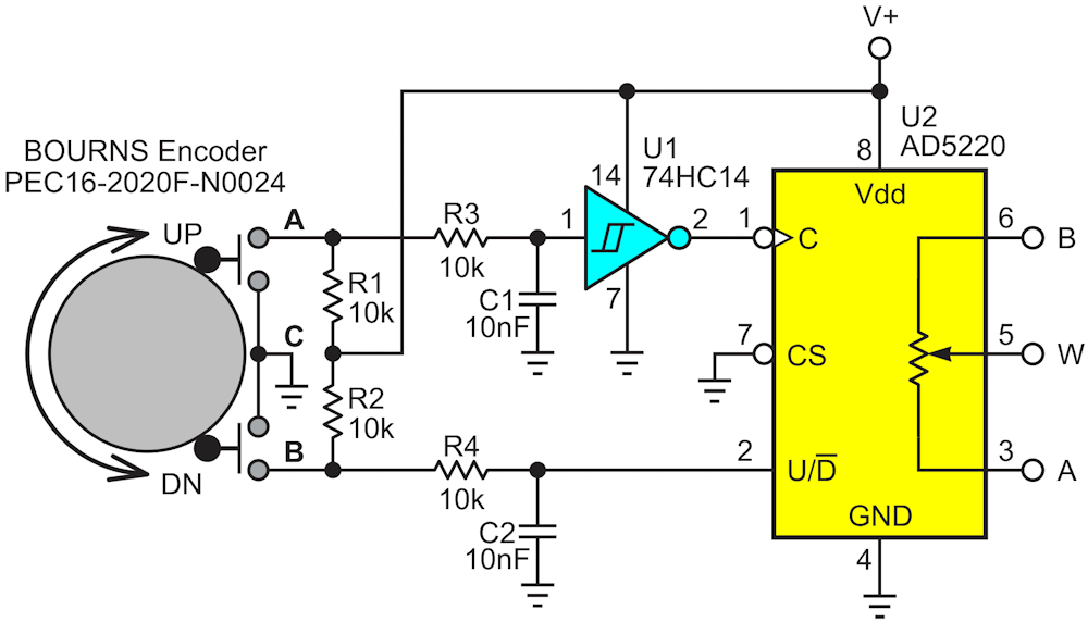

And they’re just as simple (or even moreso) to interface to an increment/decrement DPOT! Figure 1 shows how it works.
This 24 pulse-per-rev quadrature encoder can run the 128 position DPOT U2 from limit to limit with just 5 + 1/3 quick rotations, easily completed in about as many seconds.

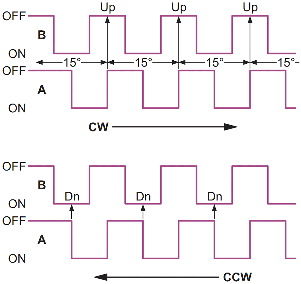

The contact-type rotary encoder generates 24 quadrature pulses per turn, as shown in Figure 2.
The quadrature phase relationship between encoder A and B contacts causes clockwise rotation to increment the DPOT setting, and counterclockwise rotation to decrement it.

Contact A provides clock pulses that are signal conditioned (debounced by R3C1) and sharpened (by Schmidt trigger U1) for presentation to U2’s edge-triggered Clock pin 1 input, causing U2 to execute an increment/decrement operation when A goes from ON to OFF.
Quadrature contact B is time-delay matched (by R4C2) and connected to U2’s Up/-Down pin 2 input. Figure 2 shows how the quadrature phase relationship between A and B causes U2 to count UP on each clock pulse when rotated clockwise, and DOWN when rotated counterclockwise.
