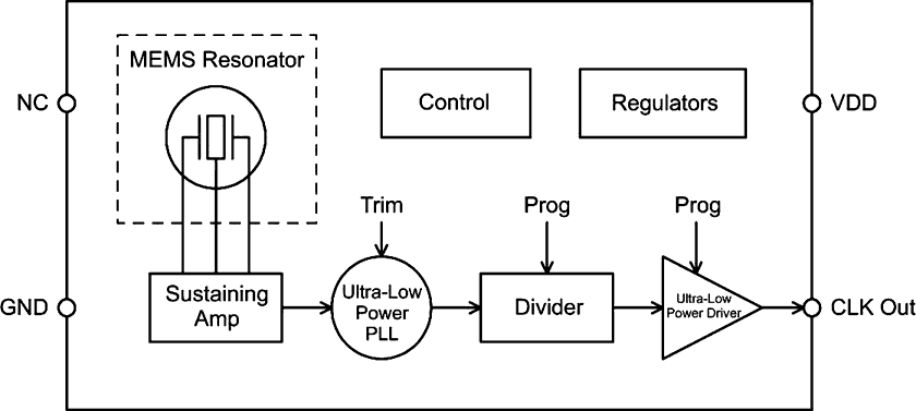

SiT1544 System Block Diagram |

- More functionality in a true one-chip solution – The oscillator output replaces crystal resonators, eliminates the need for load capacitors, minimizes board area and also offers a more robust system startup in extreme temperatures
- Excellent power savings – Supply current of only 0.75 micro-amps (typical) is 50% better than an equivalent quartz solution
