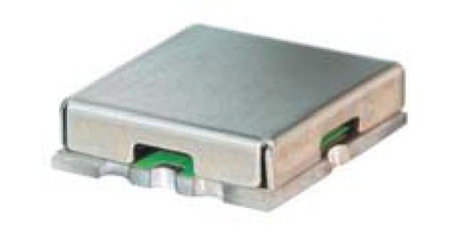

Mini-Circuits released RHP-700+  surface mount high pass filter is built with high-Q capacitors and air coil inductors for superior performance. It provides low pass band insertion loss (0.6 dB typ.), and high stop band rejection (30 dB typ.). It handles RF power inputs up to 0.5W and comes in a small case (0.35 × 0.35 × 0.15) ideal for compact designs. It has repeatable performance across lots and consistent performance across temperatures from -40 to 85°C.
The RHP-700+ high pass filter was developed for square kilometer array telescope systems for radio astronomy and additionally provides an ideal solution for applications including aeronautical/aviation, wireless communications service, and maritime.
