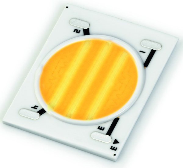

The new LEDs add to the Zenigata family with a much smaller LED in a surface-mount-device (SMD) package. The Mini-Tiger products are a departure from the prior Zenigata-branded chip-on-board (COB) LEDs. Indeed, the Mini Zenigata LEDs announced last year are in a 12×15-mm footprint. As for a tunable CCT, Sharp has previously offered that feature in larger COB LEDs, having launched the Tiger Zenigata with a 17-mm light-emitting surface (LES) back in 2012. That COB device had visible stripes of different phosphor formulations across the LES — presumably the basis for the name Tiger. The new Mini-Tiger Zenigata mid-power LED simply has side-by-side emitters with different CCTs.

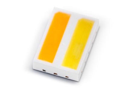

The new LEDs have only two emitters in a conventional discrete LED package. One of the emitters radiates at 6500 K and the other at 2700 K. The die are packed closely together and Sharp says the implementation will deliver uniform light with no shadows.
The Mini-Tiger LEDs are designed to be driven by dual constant-current power supplies with each channel delivering 120 mA to the LED that has a typical forward voltage of 3.1 V. For an SSL product to offer tunable performance, the design will require some local control to vary the relative drive currents to the two LED channels. Sharp has suggested that a link such as DALI (digital addressable lighting interface) would be typically used to connect a luminaire based on the LEDs.
The 2700 K emitter delivers 32 lm from the 120 mA drive current while the 6500 K emitter delivers 38 lm. Sharp said that the combined CRI will be over 80 at a minimum.
