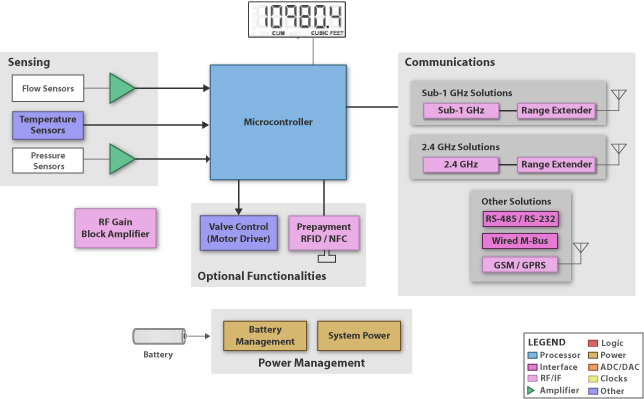

Leveraging MSP430FR69x FRAM MCUs for the smart grid
The integrated ESI module, differential ADC and LCD controller make MSP430FR69x MCUs ideal for smart flow metering designs for water, gas and heat. Adding TI's complementary SimpleLink Sub-1 GHz CC1120 transceiver, SimpleLink Wi-Fi CC3100 wireless network processor or Wireless M-Bus connectivity solutions can easily connect a new MSP430FR69x-based flow meter design to the grid. Power-conscious developers can also include TI's TPS61220 boost converter to optimize battery-powered systems. TI's new FlowESI GUI eases sensor setup in software and EnergyTrace++ technology enables developers to debug power consumption at a function- and peripheral-level like never before. These resources help developers optimize their metering designs and speed time-to-market. Get flow metering designs started quicker with three comprehensive TI Designs based on MSP430FR69x MCUs that leverage the integrated extended scan interface module. These complete reference designs for water meters using inductive-capacitive (LC), giant magneto-resistive (GMR) or optical sensors include complete block diagrams, user guides, bill of materials (BOM), design files and test reports.
