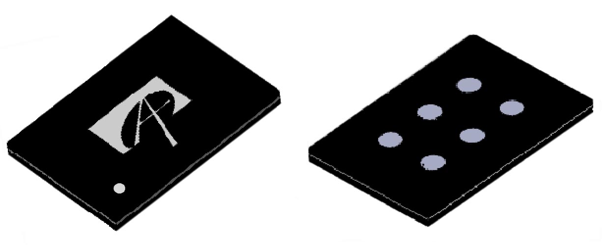

The growing demand on more data processing capabilities and longer operating time of current smart phones is driving the lithium battery toward another stage of higher capacity. At the same time, innovation in battery cell and charging technology is allowing higher charging current to power-up batteries much faster. As an essential device for battery safety design, MOSFETs with ultra-low on-resistance and small form factors are in high demand by smart phone designers. Using AOS's latest silicon technology, the AOC3864 is able to achieve a 5.7 mOhm at 4.5 V maximum source-to-source resistance within an ultra-thin 2.7 mm × 1.8 mm × 0.19 mm package. All while providing a robust structure to solve die chipping, cracking and placement issues associated with standard CSP products.
