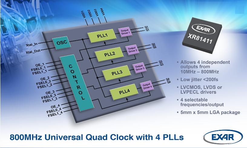

Exar Corporation announces the XR81411, a quad output, high frequency LVCMOS/LVDS/LVPECL configurable clock synthesizer. It generates any frequency in the range of 10 MHz to 800 MHz with four independent PLLs, utilizing a highly flexible delta-sigma modulator and a wide ranging VCO. The clock outputs have very low phase noise jitter of sub 0.2ps while consuming extremely low power.
Exar XR81411
The XR81411 can be used with a standard crystal or an external system clock and each independent output can be configured to select from four different frequency multiplier settings to support a wide variety of applications. Each clock synthesizer includes an integer/fractional divider allowing output frequency resolution of less than 2 Hz intervals.
The XR81411 is available in a RoHS compliant, green/halogen free, space-saving 5 mm × 5 mm LGA package. Prices start at $10.50 each for the XR81411 in 1,000-piece quantities.
Summary of features:
  • Crystal/input frequency: 10 MHz to 60 MHz, parallel resonant crystal
  • Output frequency range: 10 MHz to 800 MHz
  • VCO range: 2 GHz to 3 GHz
  • Configurable Outputs: as differential LVPECL/LVDS pair or as a single-ended LVCMOS.
  • RMS phase jitter:
  • 125 MHz (12 kHz to 20 MHz): <0.6 ps
  • 125 MHz (1.875 MHz to 20 MHz): <0.2 ps
