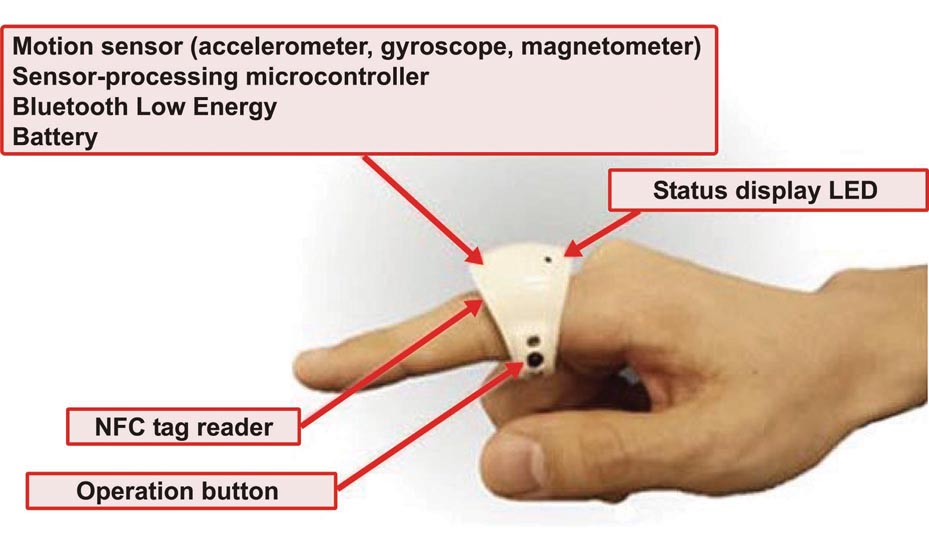

Fujitsu Laboratories Ltd has announced the development of what it calls a “compact and lightweight wearable ring-type device that offers handwriting-input functionality and a reader for near-field communications (NFC) tags.”
Smart ring allows wearer to

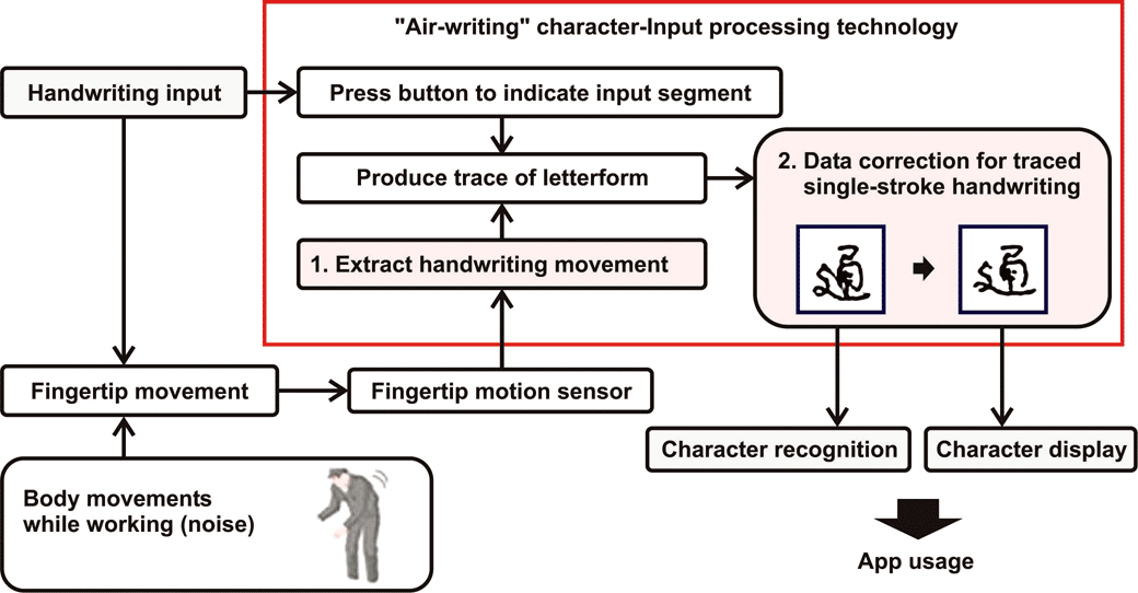

Designed to be worn on the index finger, the ring includes motion sensors (an accelerometer, gyroscope, and magnetic sensor) for text input, an NFC tag reader, and wireless communication functionality and is able to identify the movements users make with their fingertips as they write in the air. To begin air-writing, the wearer uses his or her thumb to press an operation button, which allows operation with just one hand.
It incorporates some aspects of a glove-style wearable device the company developed in 2014 but compresses the functionality into an instrument that weighs less than 10 grams and is worn on a single finger. Power-saving technology enables the use of a button-cell battery.
Fujitsu-developed technology corrects letterform tracings, improving the accuracy of character recognition, including numbers and Chinese characters, to about 95%. The built-in NFC tag reader allows users to get documentation and instructions for working on a device with the tap of a finger.
The Fujitsu Laboratories technology automatically recognizes unwanted connections between the strokes of a letterform that result from a longhand trace, and corrects the data accordingly. This correction improves legibility and text-recognition rates.
