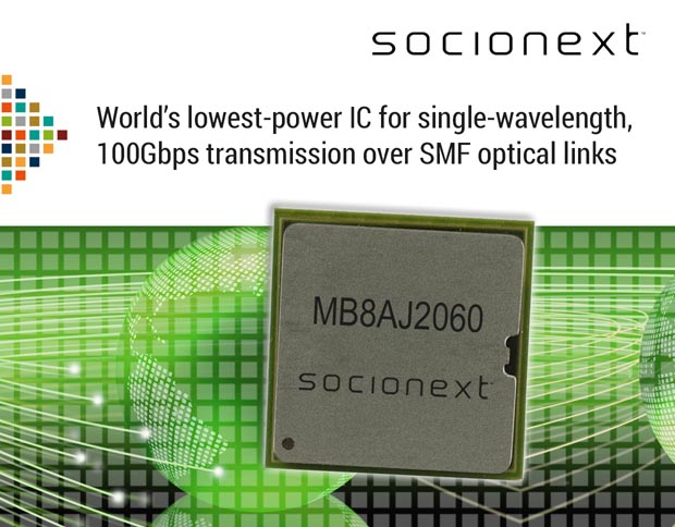

World's lowest-power IC for single-wavelength, 100Gbps transmission over SMF optical links
Socionext MB8AJ2060
DMT-based IC for datacenter interconnect and wireless infrastructure doubles capacity over existing solutions
Socionext Inc. announces the launch of the MB8AJ2060, its 100 G per wavelength, fully-integrated transceiver based on Discrete-Multitone (DMT) modulation. With a power dissipation of less than 5 W, this system-on-chip sets a new record for transmission of 100 Gbps using a single wavelength.
Socionext - MB8AJ2060
