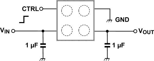

Recommended Application Circuit
Recommended Application Circuit.

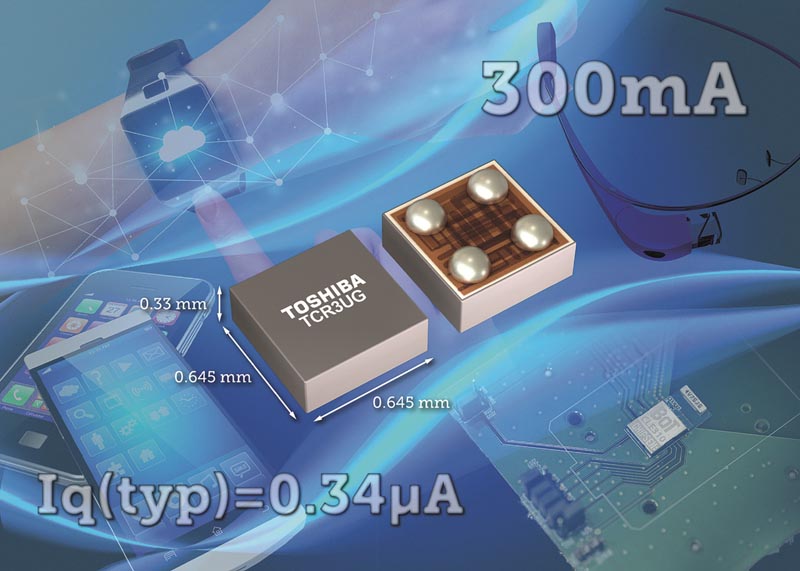

Housed in the industry-leading small WCSP4F package, which measures 0.645 mm × 0.645 mm and a maximum thickness of only 0.33 mm, the TCR3UG series helps to reduce the size and especially the thickness of mobile devices which is essential in some applications such as smart cards.
The devices have an input voltage range of 1.5 to 5.5 V DC and exhibit a quiescent current of typically just 340 nA. With this ultra-low quiescent current, they still offer an excellent ripple rejection ratio of 70 dB and a load transient response of ±60 mV.
