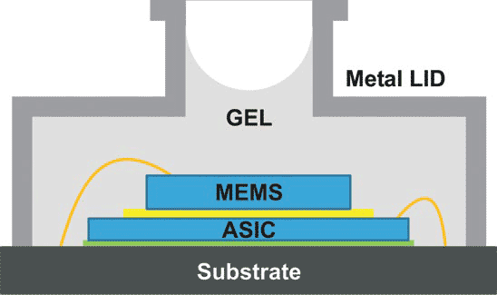

Protected by a viscous potting gel inside the cylindrical metal package, the IPx8-rated LPS33W withstands salt water, chlorine, bromine, detergents such as hand soap and shampoo, e-liquids, and light industrial chemicals such as n-pentane. The package lid provides high corrosion resistance, and the cylindrical form factor is easy to use with o-rings in applications that require a sealed enclosure.
LPS33W internal structure
LPS33W internal structure.
The unique properties of ST’s proprietary gel formula, together with the sensor’s built-in signal-conditioning ASIC, ensure class-leading 0.008 hPa RMS pressure noise thereby allowing outstanding measurement resolution. Susceptibility to reflow-soldering stress during assembly is also extremely low, drifting less than ±2 hPa and recovering normal accuracy in 72 hours; more than twice the speed of other sensors. Temperature compensation keeps accuracy within ±3 hPa over the operating range from 0 °C to 65 °C.
