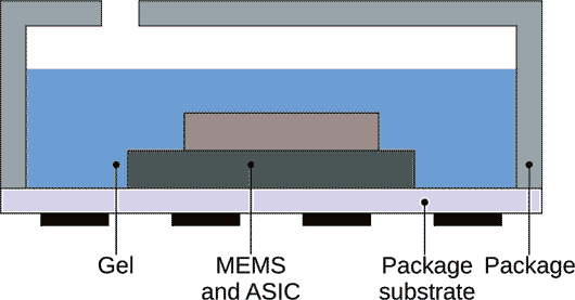

Due to its robust package, it can withstand 50 m under water for one hour (IPx8) and protects the sensing cells against dust and humidity. As a result, the board handling in an assembly line is also facilitated. The 8-pin LGA package with its small dimensions of 2.0 × 2.5 × 1.1 mm3 saves up to 80 percent space compared to other waterproof sensors.
The pressure sensor element is based on a capacitive sensing principle that guarantees high precision even during temperature changes. The internal signal processor converts the output from the pressure and temperature sensor elements to 24-bit results. Calibration coefficients stored in the sensor are used in the application to convert the measurement results to high accuracy pressure and temperature values. DPS368 provides quick feedback due to a measurement rate of up to 200 Hz and fast read-out speed. The integrated FIFO memory can save up to 32 measurement results, allowing for power-savings on system level.
Schematic drawing of DPS368 package
Schematic drawing of DPS368 package.
