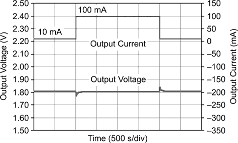

Typical Performance Characteristics. (XC6237x181:
VIN = 2.8 В, CIN = CL = 1.0 мкФ).
At light loads, high efficiency is realized by operating in PS mode with low current consumption, and at heavy loads, high speed operation is enabled by operating in HS mode. This is ideal for applications that require both low current consumption and high speed operation.

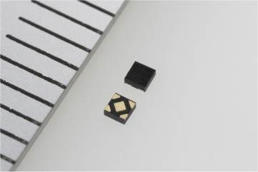

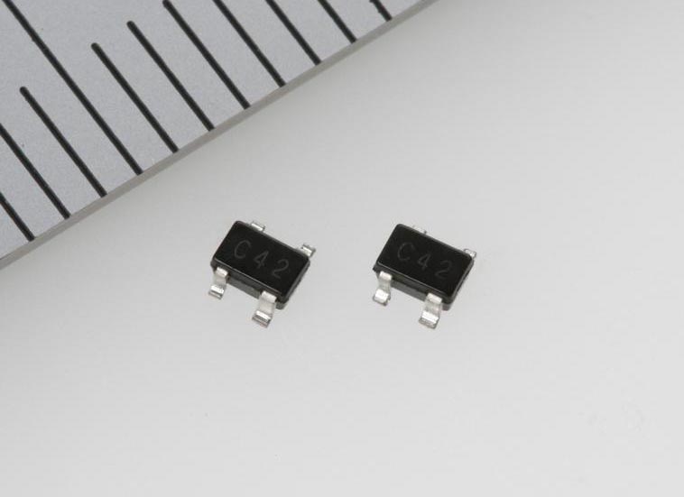

The lineup of small and thin USPQ-4B05 and general-purpose SSOT-24 are available for various applications. Low ESR capacitors such as ceramic capacitors can be used at the output of LDO.
