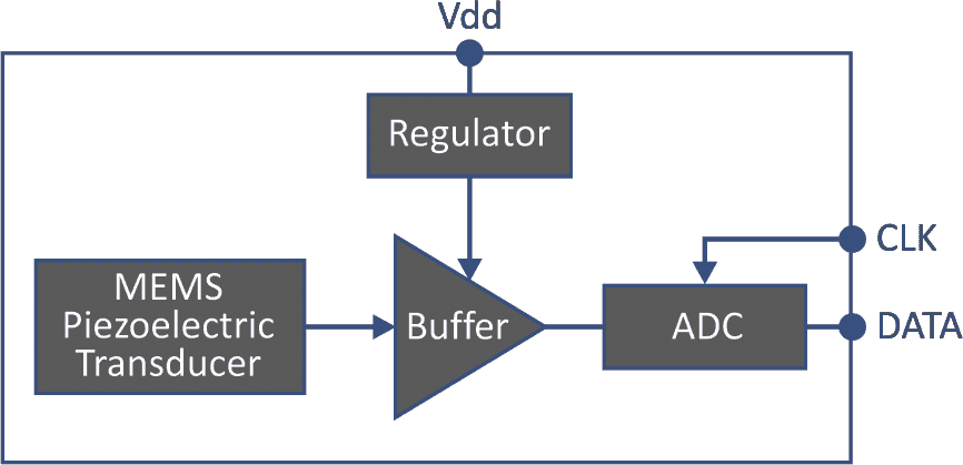

The Block Diagram of the MEMS Microphone VM3000
The Block Diagram of the MEMS Microphone VM3000.
