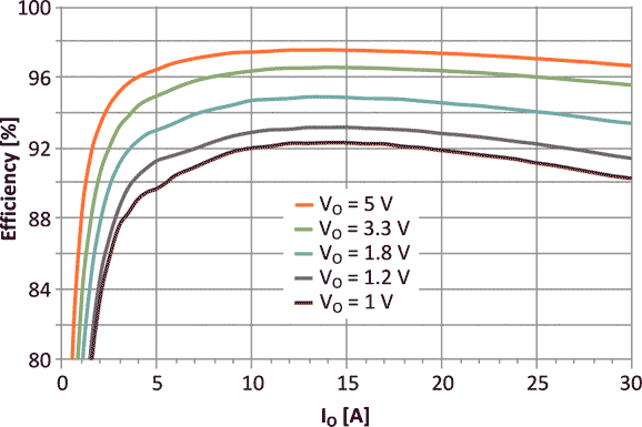

Efficiency vs. output current (VIN = 12 V, fSW = 600 kHz)
Efficiency vs. output current (VIN = 12 V, fSW = 600 kHz).
