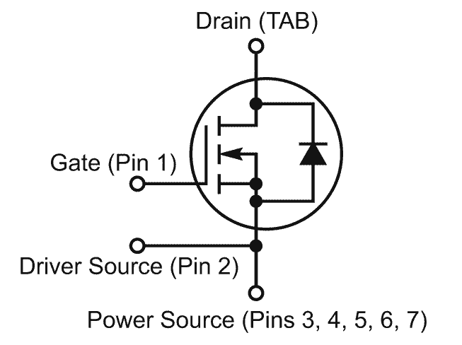

The NVBG015N065SC1 Internal Schematic
The NVBG015N065SC1 Internal Schematic.
The new generation of SiC MOSFETs employ a novel active cell design combined with advanced thin wafer technology enabling best in class figure of merit RSP (RDSON×area) for 650 V breakdown voltage. The NVBG015N065SC1, NTBG015N065SC1, NVH4L015N065SC1 and NTH4L015N065SC1 have the lowest RDSON (12 mOhm) in the market in D2PAK7L and TO247 packages. This technology is also optimized around energy loss figure of merits, optimizing performance in automotive and industrial applications. An internal gate resistor (RG) allows more flexibility to designers eliminating the need to slow down devices artificially with external gate resistors. Higher surge, avalanche capability and short circuit robustness all contribute to enhanced ruggedness that delivers higher reliability and longer device lifetimes.
