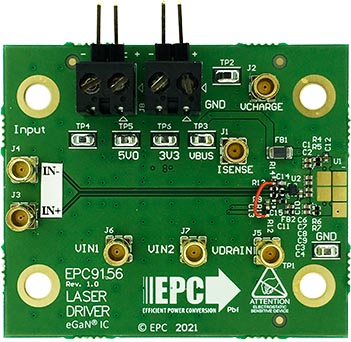

Development Board
The EPC9156 development board features the EPC21603 eToF™ laser driver IC and is primarily intended to drive laser diodes with short, high current pulses. Capabilities include minimum pulse widths of < 2 ns, 10 A peak currents, and bus voltage rating of 30 V.
The EPC9156 Development Board
The EPC9156 Development Board.
