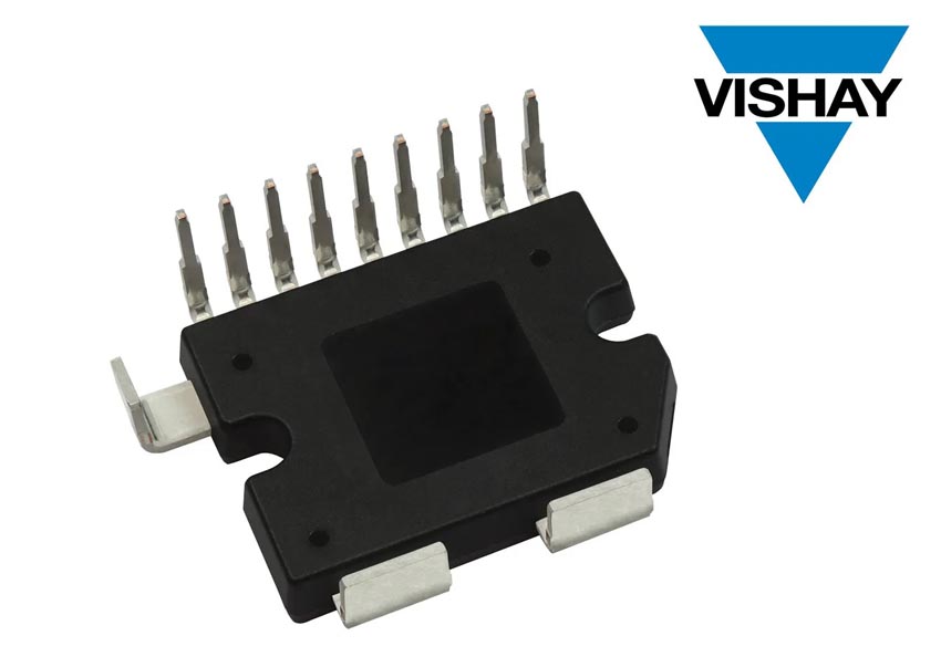

Vishay Intertechnology introduced a new 200 A power module designed to save space and increase efficiency in 48 V traction inverters for light electric vehicles (LEV) and belt-start generator / recuperation systems for mild-hybrid electric vehicles (MHEV).
Vishay - VS-HOT200C080
For these applications, the Vishay Semiconductors VS-HOT200C080 reduces board space requirements by up to 15% compared to standard discrete solutions. To increase efficiency, the integrated power module’s MOSFETs feature best in class on-resistance of 0.45 mΩ, reducing conduction losses by 32% compared to competing solutions.
The device released integrates 80 V MOSFETs in a half-bridge configuration, a shunt resistor for current reading, bypass capacitors for improved switching performance, and an NTC for temperature sensing – all in an insulated 30 mm × 22.8 mm transfer-mold FlatPAK HC0 package with an electrically isolated exposed DBC substrate.
The power module’s transfer-mold technology enables highly reliable performance over a wide operating temperature range from –55 °C to +175 °C, especially during power cycling – allowing the device to meet severe AQG-324 reliability requirements. The VS-HOT200C080’s HC0 package features signal pins and power tabs at different heights. This allows designers to have separate power and signal PCBs, simplifying designs and allowing for better routing. To save additional board space, the signal and power PCBs can be stacked.
