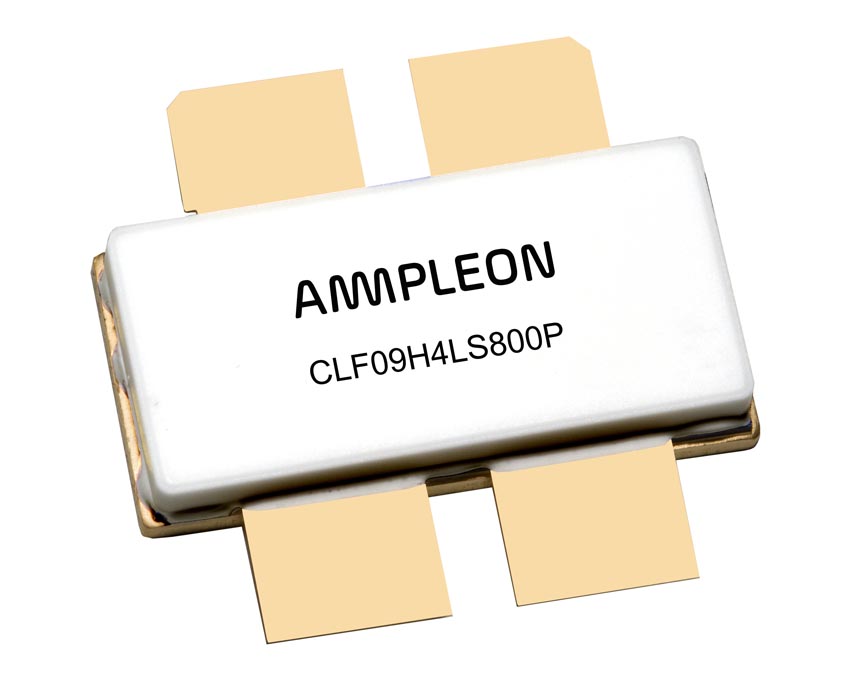

Ampleon extends its industrial GaN RF power portfolio with the new CLF09H4LS800P, an 800 W GaN-on-SiC HEMT fully optimized for the 902–928 MHz ISM band. Built for particle accelerator systems, industrial RF heating and plasma generation equipment, this new device enables OEMs to develop more efficient, cost-effective RF hardware while accelerating product go-to-market schedules.
Ampleon - CLF09H4LS800P
Delivering 800 W continuous-wave output power paired with drain efficiency above 80%, the CLF09H4LS800P achieves superior energy conversion across the targeted ISM frequency range. It minimizes power loss and reduces system thermal load, while its native pre-matched architecture eliminates additional external circuitry. The simplified RF implementation shortens design iteration and prototyping cycles, well-suited for modern high-power industrial RF deployments.
Based on Ampleon’s mature, field-validated GaN-on-SiC process technology, the transistor delivers reliable thermal dissipation and consistent long-term operational stability. It tolerates up to 10:1 VSWR load mismatch, offering robust resilience against the fluctuating and demanding operating conditions typical of industrial RF environments.
The introduction of the CLF09H4LS800P further diversifies Ampleon’s high-power GaN product offering, strengthening the company’s dedicated solution coverage for industrial, scientific and medical high-power RF energy applications.
The CLF09H4LS800P is now available for sampling and volume procurement via Ampleon’s global authorized distribution network.
