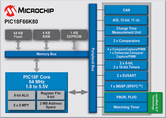

Microchip: PIC18F66K80 Block Diagram

Features
  • Featuring nanoWatt XLP Technology ideal for battery applications
  • 20 nA Sleep mode (Watch Webinar)
  • 300nA Watch Dog Timer operation in Sleep modes
  • Integrated ECAN conforming to CAN 2.0B active specification
  • Extreme Low Power Sleep mode ideal for battery applications
  • Operating voltage 1.8V – 5.5V
  • Charge Time Measurement Unit (CTMU) supports Touch sensing and advanced sensing applications
  • 11 ch, 12-bit ADC
  • 4 Capture / Compare / PWM modules and 1 Enhanced Capture / Compare / PWM modules
  • 1 MSSP serial ports for SPI or I2C communication
  • 2 Enhanced USART modules
  • Two analog comparators
  • Digital Signal Modulator
  • Self programming Flash supports 10k erase/write cycles & 20 years retention
