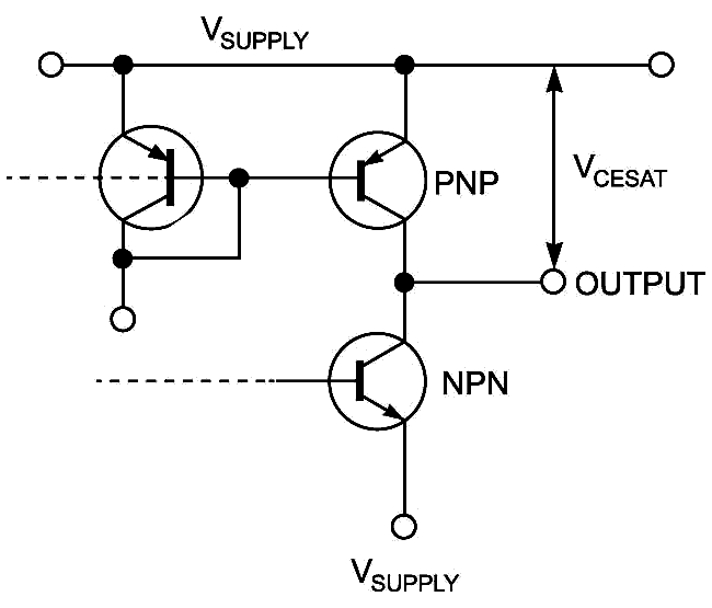

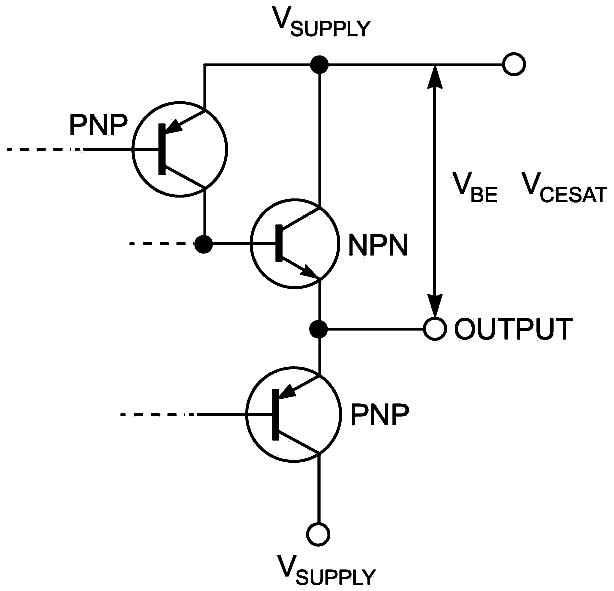

As supply voltages decreased, one of the methods engineers used to maintain a large voltage swing was to convert the classic output stage to a rail-to-rail-output stage. Figure 1 shows a classic output stage. Referring to the non-rail-to-rail output, the output can get only within approximately 1V of the positive supply. To get closer to the rails, engineers changed the output-stage transistors to a common-emitter configuration (Figure 2). The so-called rail-to-rail output can get within 50 to 100 mV of the supply, depending on the size of the output transistor and the load current.

Figure 1. In a classic output stage, referring to the non-rail-to-rail output, the output can get only within approximately 1V of the positive supply.

Figure 2. To get closer to the rails, engineers changed the output- stage transistors to a common-emitter configuration.
Comparing these two output stages, note that the classic output stage has current gain but also has a voltage gain of less than one and a low output impedance. The rail-to-rail-output stage is a common-emitter stage and thus has voltage gain of approximately transconductance times the load resistance, RL. RL comprises the external load and the output impedance of the transistor. With the output operating more than several hundred millivolts away from the rail, output impedance is large and you can usually neglect it, but not if the output is close to the rail. Also note that you can consider the output as a classic two-transistor current mirror, which turns out to be the crux of the problem.
In normal operation, the middle stage pulls down the base-collector node, driving more current into the load and raising the voltage. With negative feedback, as the output voltage rises, the input and middle stages reduce the drive until the closed loop is balanced.
When you use an op amp as a comparator, the middle stage pulls down the base-collector node, trying to close the loop. With no feedback, however, it continues to pull harder and harder. This additional current finds a path from the positive-supply pin to the negative-supply pin and appears as additional supply current. You can drive the output stage in several ways, and combining the difference in mobility between holes and electrons, the increase in supply current is usually asymmetrical.
