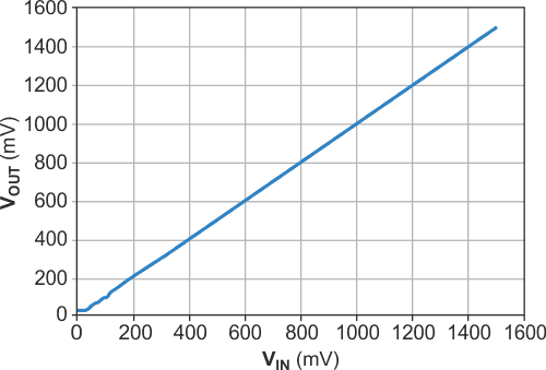

The transfer function of Figure 1's circuit is linear down to the low-millivolt level.
Figure 2. The transfer function of Figure 1’s circuit is linear down

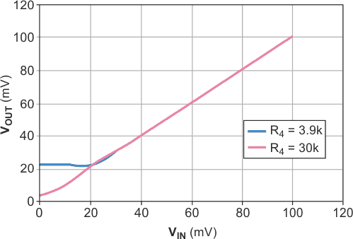

In Figure 1, Q1, Q2, and R3 form a 4-mA current source that drains the output of the LM324. R4 is the load, demanding a sink current of 4 mA. This design uses a 2N2222 transistor for its low saturation voltage. The output characteristic becomes the saturation characteristic of the added transistors, Q1 and Q2. Using this current source, the output voltage is linear down to 22 mV above ground. Figure 2 and Figure 3 show the output characteristics. The lowest usable output voltage depends on the load (sink) current. When the load current is 0.5 mA (R4 = 30 kΩ), the output voltage is linear down to 4 mV.
With 0.5-mA load current, the output voltage is linear down to 4 mV.
Figure 3. With 0.5-mA load current, the output voltage is linear down to 4 mV.

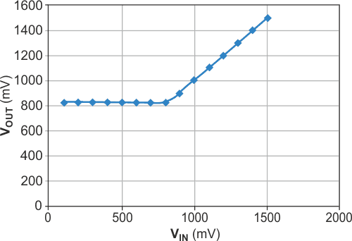

This graphic shows the LM324 transfer function without the added current source.
Figure 4. This graphic shows the LM324 transfer function without the added
current source.
Figure 4 is the original output characteristic of the LM324 driving R4 (3.9 kΩ) without the added sinking current source. The current source presents a constant load to the LM324. You can configure a leftover op amp as a voltage comparator to cut off the current source when the output voltage is higher than 1 V.
