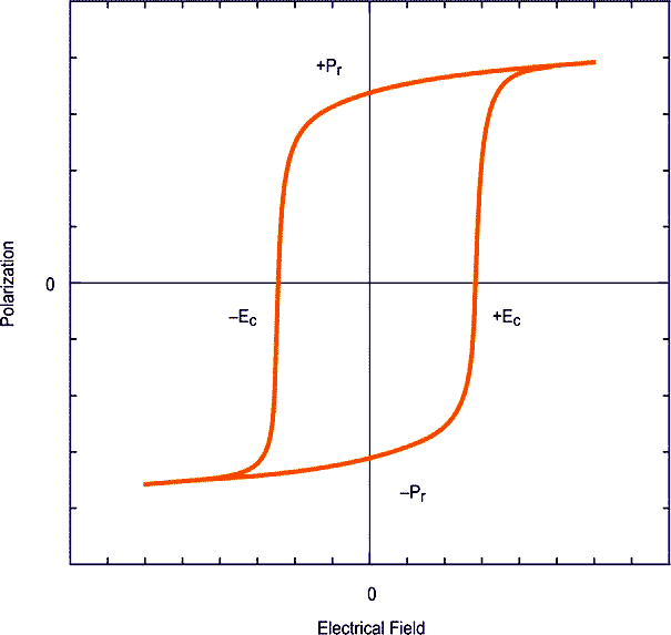

Polarization Hysteresis Loop
Figure 1. Polarization Hysteresis Loop.

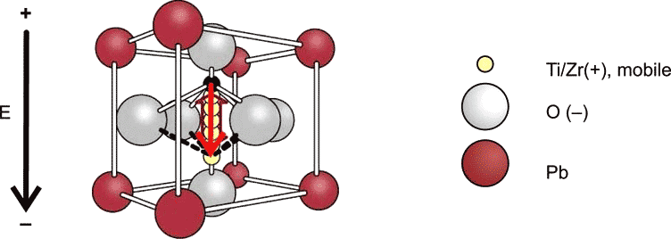

The term results from the hysteresis loop (shown in Figure 1) being similar to the magnetic hysteresis loop of iron (Fe). In contrast to the magnetic hysteresis loop, the one in FRAM results from the electrical dipole formed by zirconium (Zr) and oxygen (O) atoms in the ceramic lead-zirkonate-titanate crystal (PZT) used to implement FRAM as shown in Figure 2.
Lead-Zirkonate-Titanate Structure
Figure 2. Lead-Zirkonate-Titanate Structure.

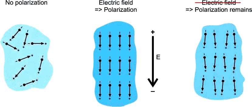

Applying an electrical field (E) can polarize the material by "moving" the Zi atom in the structure. But to move the Zi atom from one side (here from the upper) to the other side (here the lower) of the O atoms, it must cross the barrier from by the O atoms. So, with increasing field strength, the Zi atom moves gradually closer to the O atoms before – at a certain field strength – it "suddenly" flips to the other side. If a field is then applied with opposite direction, again the Zi atom would just gradually change its position before flipping to the other side. This will happen at the same field strength as before, but with an opposite sign. This behavior results in the electrical field versus polarization hysteresis loop shown in Figure 3.
Polarization
Figure 3. Polarization.
After manufacturing, the dipoles formed by the zirconium and oxide atoms are randomly polarized resulting in a net polarization of zero (no polarization). Applying an electric field aligns the dipoles and results in a polarization in the direction defined by the electric field. Because the position of the zirconium atoms within the crystal structure is stable, the polarization remains even after removing the electric field.

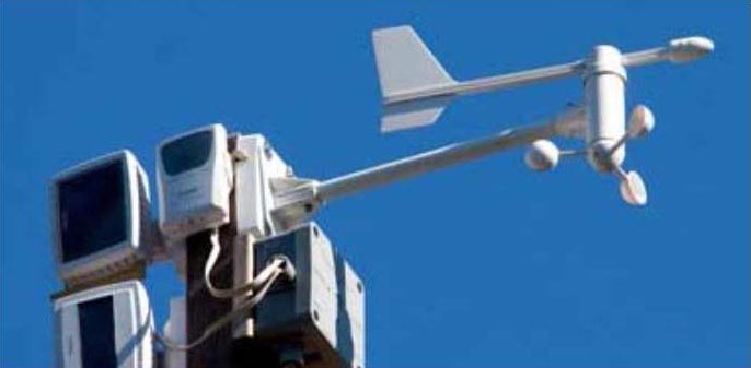

Why FRAM? – An Application Example
In the following example, the benefits of an FRAM-based microcontroller are illustrated using a data logger as application example. A data logger is typically a sensor node that collects various physical or environmental conditions like temperature, humidity, vibration, pressure, motion, or pollutants (see Figure 4).
Data Logger
Figure 4. Data Logger.

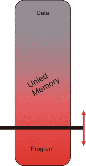

FRAM: A Universal Memory
In a data logger application, the program code size required to measure and collect the data can be comparably small with respect to the amount of memory to store the data. Assuming the use of external memory is not an option and, thus, the data should be stored in the RAM of a "traditional" flash-based microcontroller, one would have to purchase a device that has excessive program memory compared to what the application needs. With an FRAM-based microcontroller, the available memory can be partitioned to the needs of the application and, thus, a much larger portion can be made available for data to meet the application requirements.
The concept behind this is called "unified memory" (Figure 4). Universal memory allows flexible partitioning of the memory for code and data: the same type of memory can be used for both data and program storage that are "traditionally" kept in separate memories: RAM for data and flash or ROM for program storage.
Unified Memory
Figure 5. Unified Memory.
To support the "unified memory" concept, a Memory Protection Unit (MPU) is implemented in the FRAM-based MSP430 devices from Texas Instruments. The MPU allows for example to "protect" parts of the memory that are used for program storage from being overwritten accidentally.

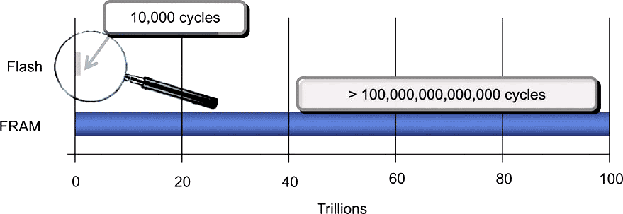

Write Endurance
The FRAM technology provides write endurance that is superior to other non-volatile memory technologies as illustrated in Figure 6. For the data logger application, that translates into a much longer lifetime with less complexity: assuming the data logger has to store one set of data each second and it always uses the same addresses, this would translate into a lifetime of a data logger using Flash memory of less than three hours (assuming a Flash with 104 cycles divided by 1 cycle per second). The same data logger using FRAM would achieve a theoretical life time of more than 3 million years making use of the more than 1014 write cycles FRAM offers. To increase the life time of the Flash-based data logger, complex wear leveling algorithms together with additional Flash memory space would be required. The wear leveling algorithms would try to make use of multiple Flash cells and use them more or less equally. For FRAM, wear leveling is not required, which significantly reduces the complexity and also the amount of memory required.
Write Endurance
Figure 6. Write Endurance.
