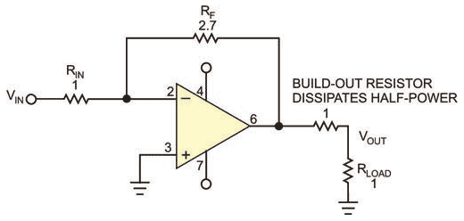

It’s common practice to series-terminate an op amp to match the impedance of the load. This practice causes a 3-dB loss of output power in the termination resistance, however (Figure 1). Newer op amps operating on 3 and 5V have limited output swings, meaning that you should avoid using series-buildout resistors. Instead, you can use a series-feedback circuit to set the output impedance. John Wittman, then a senior staff engineer at GTE Lenkurt Electric Co, introduced this technique more than 40 years ago.
Figure 1. Using a series-termination resistor equal to the load wastes 3 dB of power and reduces the output swing by one-half.

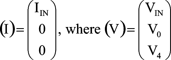

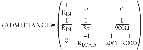

Three equations are used to analyze the circuit of Figure 3. You can express the input current as a function of the input resistance: IIN=(VIN − V−)/RIN=VIN/ RIN. As in the previous example, you sum the currents at the amplifier's negative pin to zero, 0=VIN/RIN+VOUT/28 kΩ+(V4 − V−)/900Ω, and then sum the currents at the V4 node: 0=(V4 − V−)/900Ω+(V4 − VOUT)/RLOAD+V4/20Ω.
You express the currents as a vector:
The admittance matrix becomes:
This equation determines (Y), the admittance matrix.
In this case, the input current should be 100 μA, and the load resistance should be 600Ω. Use an HP-48 calculator to invert the admittance matrix and multiply it by the current matrix. The resulting voltage matrix yields an input voltage of 1V, an output voltage of − 1.4V, and a V4 of − 0.05V. Next, set the load to 10,000Ω. Assume that the magnetizing inductance of the transformer is infinite. You then repeat the exercise to check that the output voltage is |2.8V|.
