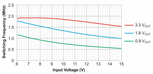

Without any designer intervention, AEE adjusts the switching frequency to increase efficiency while using the same output filter and loop compensation. The switching frequency is automatically adjusted, based on the input voltage and output voltage, to maximize efficiency while maintaining control-loop stability and output-filter effectiveness. The frequency needn’t be set at a specific operating point optimized only for certain operating conditions; it dynamically adjusts itself during operation. Figure 1 shows the switching frequency for 3.3-, 1.8-, and 0.9-V output-voltage circuits running at 6 A of load current across a 6- to 15-V input-voltage range.
For lower output voltages, the switching frequency is reduced to maintain an appropriate amount of ripple current in the inductor. In the more common peak-current-limit type of step-down converter IC, the peak inductor current defines the IC’s available output current.

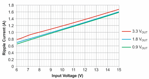

With the fixed level of the current limit set inside the IC, the peak inductor current must remain below the current-limit level at the full output current. Since the peak inductor current is the output current plus half of the inductor ripple current, the ripple current must be maintained at a low enough level. Otherwise, current limit is reached too soon and the IC is unable to provide the necessary output current.
With lower output voltages, the inductor ripple current is already reduced through Equation 1:
  (1)
Because of this reduction, the switching frequency is also reduced with lower output voltages, increasing the ripple current back toward its allowed level. Figure 2 depicts the inductor ripple current calculated from the frequency data in Figure 1 and Equation 1.

At a given operating point, the ripple current is essentially the same, regardless of the output voltage. AEE achieves this by reducing the switching frequency at the lower output voltages. Such a reduction narrows the gap in efficiency that occurs with decreasing output voltage.
AEE Boosts Efficiency for Lower-Output-Voltage Step-Down Converters
Figure 2. AEE provides a constant ripple current at a given input voltage for any output voltage.

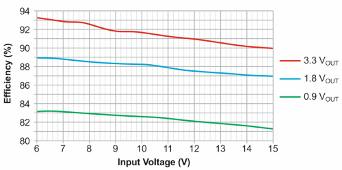

Figure 3 shows the efficiency when implementing AEE.
Figure 3. A two-phase step-down converter narrows the efficiency gap at
lower output voltages through AEE.
Because the lower frequency at lower output voltages reduces switching losses, it also reduces total loss. This increases efficiency as opposed to most power-conversion topologies, which maintain a constant frequency for all output voltages.

In step-down converters such as the TPS62180, AEE provides higher efficiency than fixed-frequency, step-down converter topologies for lower output voltages. With AEE, 91% efficiency for a 3.3-V output voltage is maintained at a high level for lower output voltages: 87.5% for a 1.8-V output voltage and 82% for a 0.9-V output voltage. Such efficiencies represent a 3.5% and 9% increase, respectively, compared to fixed-frequency topologies. These efficiency increases are greatly valued in portable devices such as tablets, as well as thermally sensitive devices like SSDs and servers.
