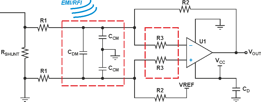

The second option is to add external EMI/RFI filters to the input of the op amp. This may be the only option if a design requires using a device that does not include internal EMI filters. Figure 2 shows a standard difference-amplifier configuration using external DM and CM filters that are targeted at higher EMI frequencies. Without input filters, the circuit gain is |R2/R1|. If passive input filters are added, R3 resistors are typically needed to prevent the CDM capacitor from reducing the phase margin of the amplifier. The DM low-pass filter consists of both R1 resistors, CDM, and both CCM capacitors. The CM low-pass filter uses both R1 resistors and both CCM capacitors.
| Figure 2. | Passive EMI/RFI input filters improve high frequency immunity. | |
Equations for the –3-dB cutoff frequencies of the DM and CM filters (fC_DM and fC_CM) are shown below. fC_DM is set at a frequency above the desired bandwidth of the op amp circuit, and CDM is typically determined first. CCM capacitors are then chosen to be at least ten times smaller than CDM to minimize their impact on fC_DM, and because CCM capacitors are targeting higher frequencies. As a result, fC_CM will be set to a frequency higher than fC_DM. Note that an EMI-hardened device can be used to eliminate the components boxed in red and simplify the design.
(3) |
(4) |

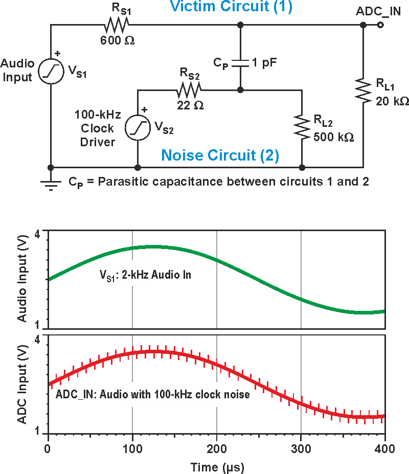

The diagram in Figure 3 represents two circuits. The first is an audio circuit that represents the input of an analog-to-digital converter (ADC) is comprised of a 1-VP-P, 2-kHz sinusoid (VS1), 600-W source impedance (RS1), and a 20-kW load impedance (RL1). Source impedances like 600 W are common in audio applications for sources such as microphones and high-input impedances like 20 kW are common for audio ADCs. The second circuit is a 100-kHz clock source driving a 3.3-V clock signal (VS2) with a series-termination resistor of 22 W (RS2) and load impedance of 500 kW (RL2). The high-impedance load represents the digital input of another device.
| Figure 3. | Clock noise source and audio victim circuit. | |

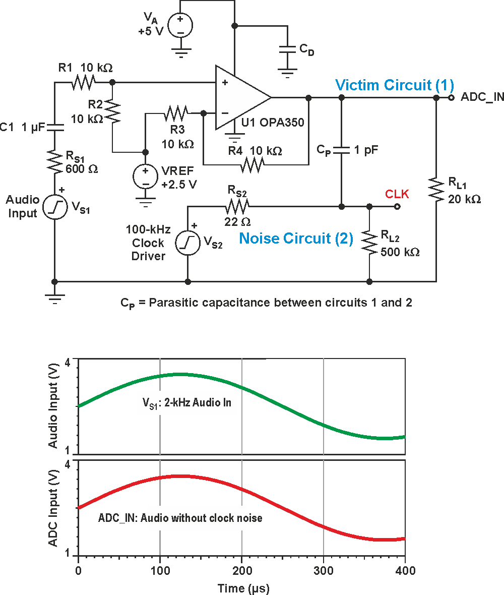

In a real system, I2C serial bus clocks in the 100- to 400-kHz range are common around audio ADCs and circuits. Although I2C clocks are typically driven in bursts (not continuously), this simulation shows the possible impact during the time the clock is driving. A clock routed near a sensitive audio trace is a real possibility on high-density audio and infotainment PCB designs. For capacitive coupling to occur, it takes only a few picofarads of parasitic PCB capacitance to inject clock noise current into the victim audio signal. This is simulated using only 1 pF of parasitic capacitance, as shown in Figure 3.
| Figure 4. | Op amp circuit reduces EMI from clock source. | |
How can noise be reduced in the audio circuit? As it turns out, reducing the impedance of a victim circuit is one way to reduce its susceptibility to coupled noise. For circuits with relatively high source impedance (> 50 W) coupled-noise can be reduced by minimizing the source impedance seen by the circuit load. In Figure 4, a noninverting configuration of the OPA350 is added to the circuit to buffer the signal and isolate the source impedance from the load. Compared to 600 W, the output impedance of the op amp is very low, which significantly reduces the clock noise.
