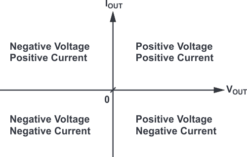

Figure 2 shows what four-quadrant means in relation to a power supply. The quadrants of a coordinate system are shown with voltage on the x-axis and current on the y-axis. Current and voltage can be either positive or negative.
Shown is an example of a four-quadrant voltage converter.
Figure 2. Shown is an example of a four-quadrant voltage converter.
The dc-dc converter can thus be used as an energy source and as an energy sink. In other words, the converter can function as a power supply or an electric load.
