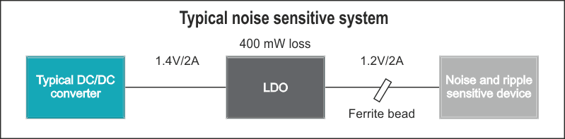

A typical low-noise architecture using a DC/DC converter, LDO and ferrite-bead filter.
Figure 1. A typical low-noise architecture using a DC/DC converter, LDO and ferrite-bead filter.
The traditional setup for powering a clock, data converter or amplifier is to use a DC/DC converter, followed by a low-dropout regulator (LDO) such as the TPS7A52, TPS7A53 or TPS7A54, followed by a ferrite-bead filter, as shown in Figure 1. This design approach minimizes both noise and ripple from the power supply and works well for load currents below approximately 2 A. As loads increase, however, the power loss in the LDO introduces issues in efficiency and thermal management; for example, a post-regulation LDO can add 1.5 W of power loss in a typical analog front-end application. Are those of you looking for low noise and efficiency in your design out of options? Not quite.

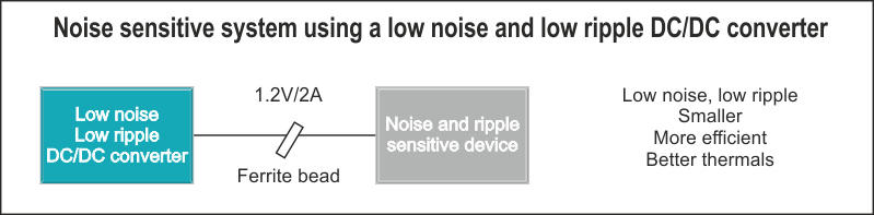

One way to keep the power loss in check is to minimize the dropout through the LDO. However, this approach will have a negative impact on noise performance. Additionally, higher-current LDOs are typically larger, which can increase design footprints and cost. A more effective way to ensure low noise while controlling the power loss is to eliminate the LDO from the design altogether and use a low-noise DC/DC buck converter, as shown in Figure 2.
Using a low-noise buck converter without an LDO.
Figure 2. Using a low-noise buck converter without an LDO.

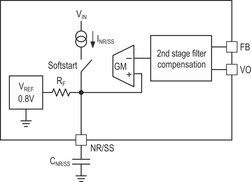

I know what you’re thinking: How does removing the primary device that reduces noise still provide a low-noise supply? Many LDOs have a low-pass filter on the bandgap reference to minimize the noise into the error amplifier. The TPS62912 and TPS62913 family of low-noise buck converters implement a noise-reduction/soft-start pin for connecting a capacitor, forming a low-pass resistor-capacitor filter using the integrated RF and externally connected CNR/SS, as shown in Figure 3. This implementation essentially mimics the behavior of the bandgap low-pass filter in an LDO.
Low-noise buck block diagram with bandgap noise filtering.
Figure 3. Low-noise buck block diagram with bandgap noise filtering.

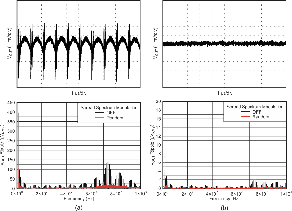

Every DC/DC converter generates an output voltage ripple at its switching frequency. Noise-sensitive analog rails in precision systems need the lowest supply voltage ripple to minimize frequency spurs in the spectrum, which typically depend on the switching frequency of the DC/DC converter, inductor value, output capacitance, equivalent series resistance and equivalent series inductance. To mitigate the ripple from these components, engineers often use an LDO and/or a small ferrite bead and capacitors to create a pi filter to minimize ripple at the load. A low-ripple buck converter such as the TPS62912 and TPS62913 leverage this ferrite-bead filter by integrating ferrite-bead compensation and remote-sense feedback. Using the inductance of the ferrite bead in combination with an additional output capacitor removes the high-frequency components in the output voltage ripple and reduces the ripple by approximately 30 dB, as shown in Figure 4.
Output voltage ripple before the ferrite-bead filter (a); and after the ferrite-bead filter (b).
Figure 4. Output voltage ripple before the ferrite-bead filter (a); and after the ferrite-bead filter (b).
