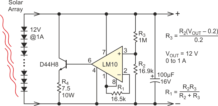

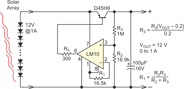

Figure 1 illustrates a suitable series regulator while Figure 2 is a comparable shunt topology. To ease comparison of the advantages of shunt versus series regulation, both regulators employ identical sense/control circuitry based on the venerable LM10 combo reference + op amp.
A suitable shunt linear regulator for small solar arrays.
Figure 2. A suitable shunt linear regulator for small solar arrays.

In Figure 1 (series regulator), pin 6 connects through current-limiting R4 to the base of the D45 PNP pass power transistor, increasing drive and load current when VOUT < VSETPOINT, decreasing them when VOUT > VSETPOINT. In Figure 2 (shunt regulator), pin 6 drives the base of the D44 NPN shunt transistor, routing more array current to ground when VOUT < VSETPOINT, less when VOUT > VSETPOINT.

Full-load (1 A) efficiency of the series topology, when the D45 pass transistor will be ON and near saturation, is limited by three factors:
  1. Current draw of the LM10 and R2R3 voltage divider = 312 µA (typ)
  2. Base drive for the D45 @ IC = 1 A = 10 mA (typ)
  3. Saturated voltage drop of the D45 @ IC = 1 A = 100 mV (typ)
Summing these losses produces an estimated typical efficiency factor of 98%.
By contrast, in the shunt topology the D44 power transistor is completely OFF at full load and the connection between array and output is direct, leaving only one of the three factors outlined above to compete for output current: #1 – the 312 µA LM10 current. This results in near-perfect 99.97% efficiency.

Maximum heat dissipation of the D45 series pass transistor is ~1.33 W, occurring at 0.66 A load current, which can be accommodated by a small clip-on heat sink. Maximum dissipation of the D44 shunt transistor, by contrast, occurs at zero load current, and is much greater: ~4.5 W, requiring a substantial and bulky extruded sink to acceptably limit temperature rise (~40 °C) under conditions of natural convection and radiation.

Series regulation causes most of the power that’s not accepted by the load to be dissipated by the array (remember how cool the D45 stays), while shunt regulation dissipates rejected power in the D44 transistor and R4. Thus, at partial load, a 20% efficient shunt regulated panel runs cooler than the series regulated panel, by as much as 10 °C. Solar array conversion efficiency declines with temperature rise by 0.3% to 0.4%/°C, so that a shunt regulated panel may be 3% or 4% more efficient than a series regulated panel in some circumstances.
By this criterion shunt regulation is obviously superior.
