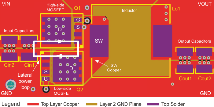

Figure 1 shows a single-sided layout of a synchronous buck regulator with discrete power MOSFETs, Q1 and Q2, in popular SON 5 × 6-mm case size. Placement of input capacitor Cin1 near the MOSFETs results in a high-frequency switching loop with lateral orientation and a relatively high area of almost 20 mm2. A layer-2 (L2) ground (GND) plane acts as an image plane for currents on the top layer, providing a flux cancellation effect. Still, the parasitic loop inductance is quite high, greater than 1 nH.
Synchronous Buck DC/DC Regulator PCB Layout With Laterally Oriented Switching Loop.
Figure 1. Synchronous Buck DC/DC Regulator PCB Layout With Laterally Oriented Switching Loop.

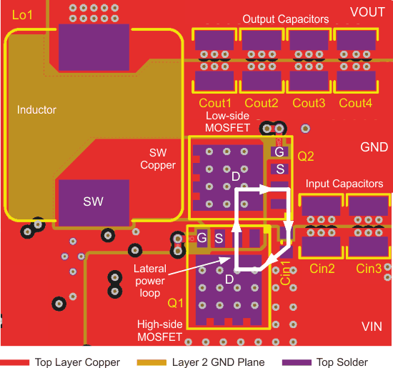

The layout in Figure 2 is modified so that the high-side FET (Q1) is rotated 90°. This improves heatsinking of Q1 for better thermal management, and allows convenient placement of capacitor (Cin1) in 0603 case size near the MOSFETs for high-frequency decoupling. Also note the U-shaped layout orientation of the power-stage components positions the output capacitors for a shorter return connection to the lowside MOSFET and input capacitors.

Figure 2. Improved Lateral Switching Loop Design.

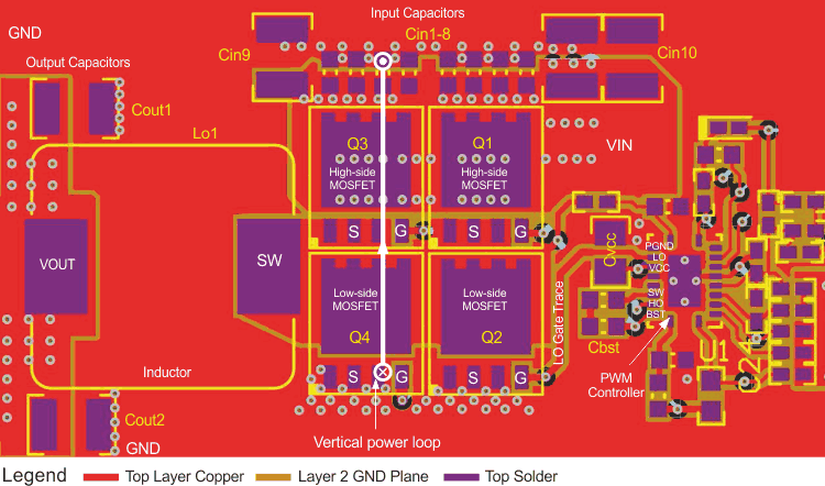

Figure 3 shows a proposed layout with the benefit of a reduced switching power loop area and lower EMI using a multilayer PCB structure. The design uses layer 2 of the PCB as a power-loop return path directly underneath the top layer to create a small physical loop area of 2 mm2. The currents flowing in opposing directions in the vertical loop configuration provide field self-cancellation, further reducing parasitic inductance.
For completeness, Figure 3 also includes the layout of the LM5146-Q1 100-V synchronous buck controller. Surround the regulator in the GND pad geometry to connect an EMI shield if needed.

Figure 3. Vertically Oriented Switching Loop Design.

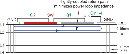

Figure 4 shows a side view to illustrate the concept of creating a low profile, self-canceling loop in a multilayer PCB structure. The L2 GND plane layer provides a tightly coupled current return path directly under the MOSFETs to the source terminals of Q2.

Figure 4. PCB Stack-Up Depicting Switching Loop With Low Area Using Layers L1 and L2.

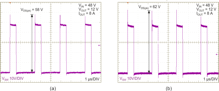

Figure 5(a) shows the switch-node voltage waveform measured with a wide-bandwidth probe using the optimized layout of Figure 3. With a parasitic loop inductance less than 500 pH, ringing is not evident, just a low-amplitude overshoot and negligible undershoot, which bodes well for EMI performance above 30 MHz.

Figure 5. Switch-Node Voltage Waveforms With Vertical Loop Layout (a); Lateral Loop Layout (b).
For comparison, Figure 5(b) shows a similar measurement using the same circuit, but with the lateral loop layout of Figure 2. The peak overshoot of the optimized layout is lower by approximately 4 V.

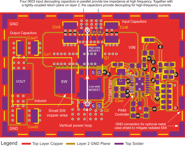

Figure 6 shows a layout that supports paralleled FETs. Similar to the layout technique shown in Figure 3, the four power MOSFETs, two each for high-side and low-side positions, provide additional current capability and improved thermal performance.

Figure 6. Paralleled MOSFET Layout Design.
Again, the 0603-sized input capacitors conduct high-frequency currents, while the adjacent 1210 capacitors provide low-frequency bulk decoupling.
