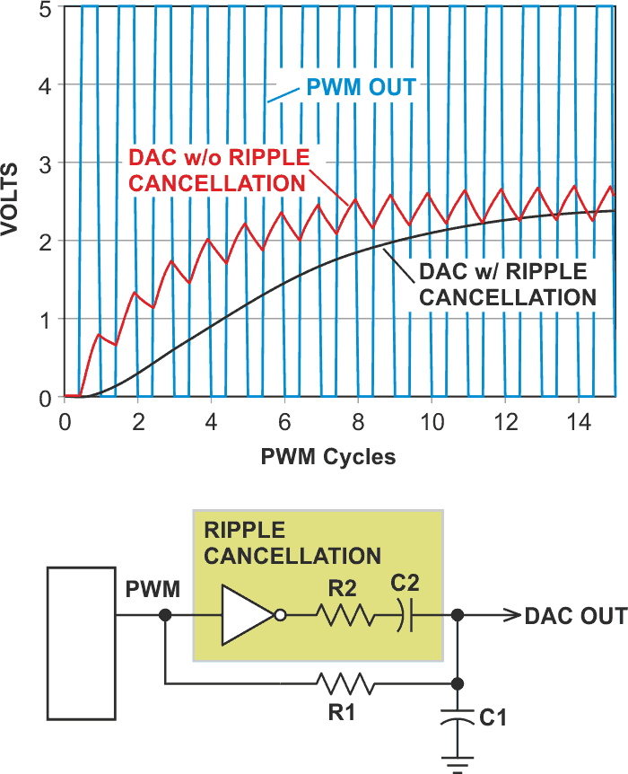

Clearly, if settling time is a critical design parameter, we’ll need to do better and find a less simplistic filtering scheme. The extreme possibilities that lie in this direction are illustrated by my previous DI  [1]
But not every application that can’t tolerate molasses-in-January 355•TPWM settling times need or can justify such a complex filtering solution. The Design Idea presented here addresses these middle-of-the-road applications. As shown in Figure 1, it augments the basic R1/C1 low-pass with an inverter, R2, and C2, which combine to negate and subtract (most of) the undesired AC component from the wanted DC signal, leaving a relatively clean analog output with settling time much less than a simple RC filter.
Схема подавителя пульсаций ШИМ ЦАП и временные диаграммы сигналов.
Figure 1. Waveforms & schematic of PWM DAC ripple canceller.
But how pure is “relatively clean”, and how fast is “much less”? Setting R2 = R1 and C2 = C1, the ripple and settling time figures for the new circuit are:
Referring again to the 8-bit case (illustrated graphically in Figure 1):
Given:
Then:
With a 32 kHz cycle, it’s 16 times faster, with a squared ripple-amplitude ratio!
For many applications, this represents a very worthwhile tradeoff between a modest increase in circuit complexity and a significant increase in PWM DAC performance.
