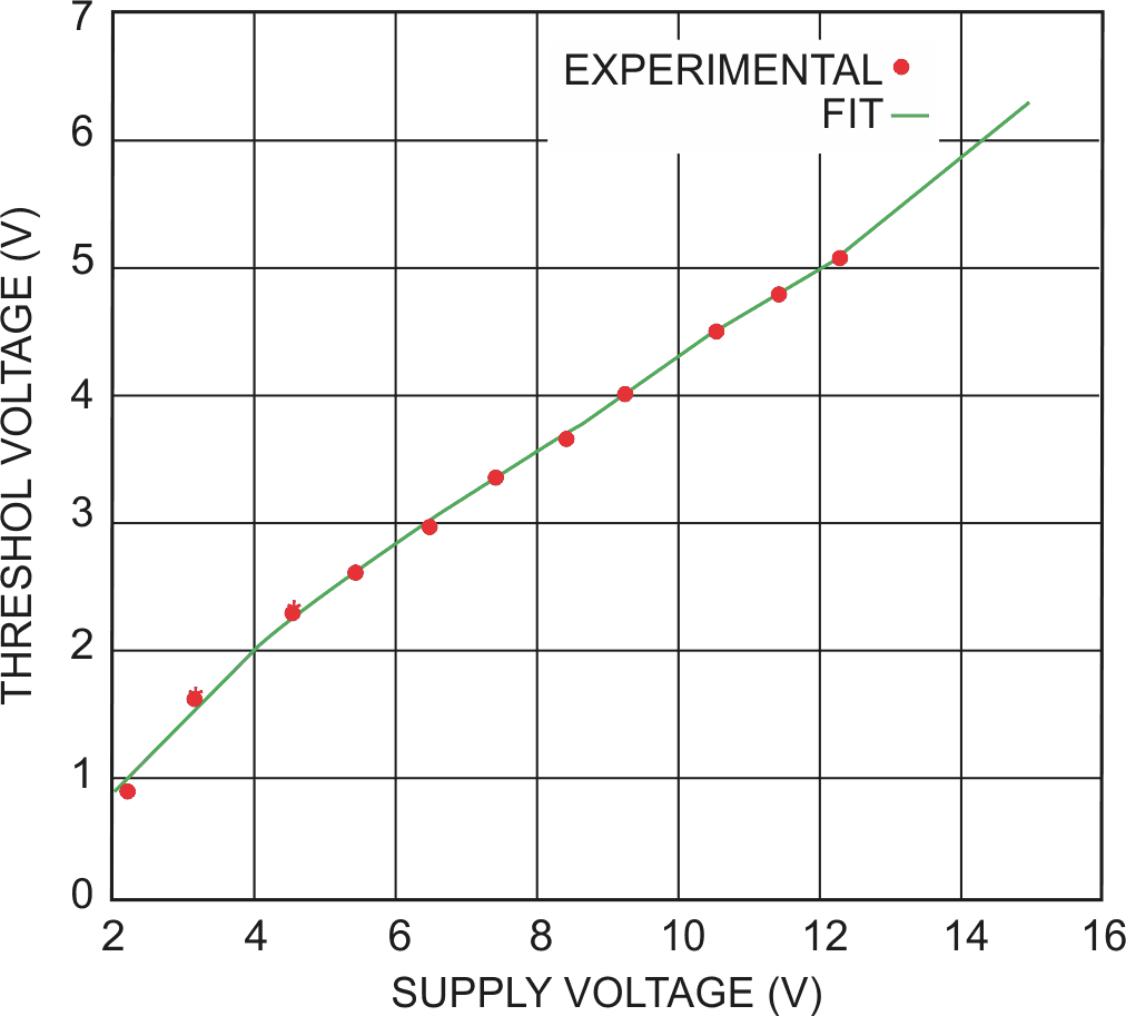

You can vary the CMOS gate’s supply voltage to attain the desired threshold voltage for the gate input. If you apply the unknown voltage to one of the gate’s inputs and then connect the other input to the positive-voltage supply, you can vary the supply voltage, VS, until you reach a point at which the threshold voltage at the input becomes equal to the unknown voltage.
The gate's threshold voltage is nearly linear with respect to the power-supply voltage.
Figure 2. The gate’s threshold voltage is nearly linear with respect to the
At this point, the output of the sense gate, IC1A, changes from logic zero to logic one. When this event happens, the threshold of the gate passes the unknown voltage. You can estimate the unknown voltage using a graph of threshold voltage versus supply voltage, such as the one in Figure 2. By fitting a parabola or a polynomial to the experimentally obtained points – say, some 20 points lying in the supply-voltage range of 2 to 15 V – you can estimate the threshold voltage, VT, for any supply voltage. This circuit has been built and tested.
