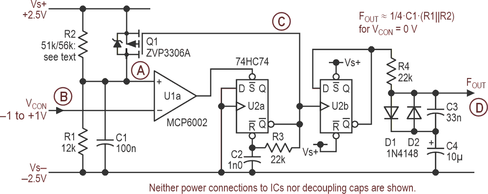

An exponential decay may not give the exact curve we need, but with a little tweaking, parts of it are close enough to be useful. Some experimenting produced the workable circuit shown in Figure 2.
| Figure 2. | Varying the reference voltage instead of the R-C time-constant gives a tuning law that is close enough to being linear in pitch over a couple of octaves, especially after adding R2. |

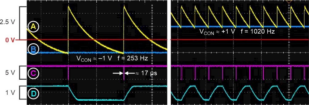

Just as described above, the bipolar control voltage is compared with the falling exponential(-ish) ramp to tune the oscillator’s frequency. When they coincide, U2a, used as a multi-supply multi-voltage (MSMV), is triggered to produce a reset pulse to turn Q1 on momentarily, thus resetting C1’s voltage to its maximum value. Figure 3 shows the key waveforms.
| Figure 3. | Waveforms from the circuit in Figure 2, at both extremes of its two-octave span. |
Bending the law so we can do what we want
The single, simple, humble resistor R2 is the key to this design. By compressing and shifting the exponential decay curve, it allows a reasonably close approximation to a tuning law that is linear with pitch rather than frequency over a couple of octaves and more: an increment in the control voltage now changes the frequency by a fairly constant frequency ratio rather than a fixed amount. The match is worst at the low-frequency end, being around 5% off close to the low calibration point and way off even lower down. (A semitone is ~7%.) Using 51k for R2 gives the closest match for the bottom octave frequency itself, but 56k generally “sounds” better on average in that region.
With the values shown, the output frequency ranges from about 250 Hz to 1000 Hz for inputs from –1 to +1 V, which is close to the two octaves upwards from “C4” (middle C: ~262 Hz if we define A4 to be precisely 440 Hz) to “C6”. (The quotes are used here to distinguish pitch values from capacitors!) For different spans, just change C1 or both R1 and R2, whose ratio must be kept constant. If the control voltage falls below about –1.5 V, as determined by R1 and R2, oscillation will stop. Above +1 V, the match is still reasonable for another half octave and more.
U2b divides the oscillator’s pulse output by 2 to give a square wave, which the output network turns into a trapezoid of about 1.1 V pk-pk (~–6 dBu). While this has no pretensions to waveform purity, it does now have softer and “more analog” edges rather than sharp digital ones.
Other comments: MCP6002s are cheap and cheerful. The MCP6022 is better specified (much faster, and with <500 µV input offset) but more costly. The spare half of U1 could be used for further filtering of the output if desired. The spec for Q1 is not critical. A ZVP3306A has an RDS(ON) of up to 15 Ω, but the width of the pulse driving its gate ensures that C1 is fully charged under all conditions. The ~±1 V control range was just what I wanted, but that was a happy accident rather than being designed in.

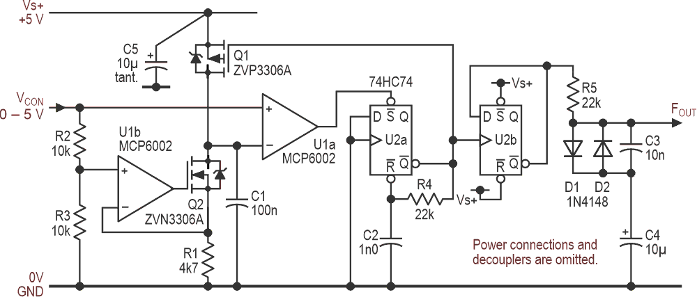

A few extra components give more octaves and accuracy
Contemplating the basic circuit threw up an interesting idea. Linear-in-frequency tuning can be done in two ways, one being to use a linear ramp and vary the control voltage much as we’re doing with the exponential one, while the other would be to replace R1 with a controllable current sink and delete R2. Use these together and the tuning law becomes “squared”, giving a power law that is inherently much closer to being linear-in-pitch. Figure 4 shows how to do that.
| Figure 4. | Adding a voltage-controlled current sink in place of tuning resistor R1 is the key to operation over more than 4 octaves with much better pitch accuracy. |
Q2, U1b, and R1 form the current sink. Its control voltage is half of that at the input, ensuring that Q2 never saturates. C1 discharges linearly, the slope being governed by VCON. The power rails are shown as 0 V/+5 V rather than ±2.5 V to reflect the wider tuning range, but the output frequency is still centered at around 520 Hz (close to a pitch of “C5”) with the component values shown.
The required control-voltage swing now measures ~840 mV/octave (or ~70 mV/semitone). The response is almost exactly linear-in-pitch over the middle two octaves, and still decent for the two octaves and more surrounding those. The errors are worst at the low-frequency end because the current sink is then running out of steam (or electrons). An MCP6022 is used because of its better performance but the rest of the circuit is almost unchanged.
While the range of 4-plus octaves is over the top for my target application, improved accuracy is always welcome, and this better performance opens the way to possible musical use.
