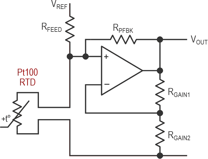

That heart is the fairly conventional circuit shown in Figure 1.
A simple circuit feeds the RTD, amplifies the resulting voltage, and uses some positive feedback to compensate for the sensor's non-linear response to temperature.

Fairly obviously, VREF and RFEED drive current through the RTD producing a voltage that is amplified by
That voltage is only nearly proportional to absolute temperature, so RPFBK adds a little positive feedback to (almost) linearize the output. Its value is critically dependent on RFEED and the gain, and, as described in Ref 2, is best found by iterated simulation. (Though later, we’ll see a useful shortcut.) Figure 2 shows the resulting error curve, which scarcely changes for gains above ~3 once RPFBK has been optimized.
