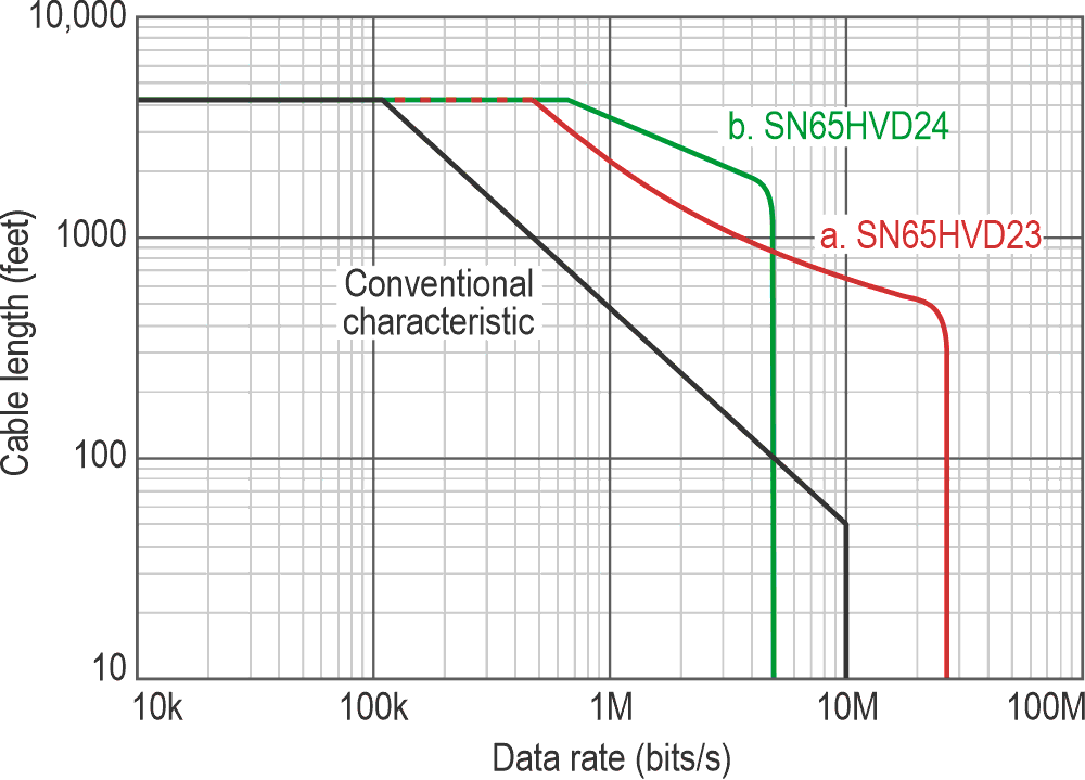

Data rate versus cable length
Figure 1 shows the conventional cable length versus data rate characteristic. At about 4000 feet, the voltage divider action between the cable resistance of a 24 AWG twisted-pair cable and the termination resistance matching the characteristic line impedance reduces the signal strength by half (6-dB attenuation). This drop serves as a reference for the maximum cable length, which is why many long distance networks mainly transmit at 10 to 20 kbits/s, rarely at 100 kbits/s.

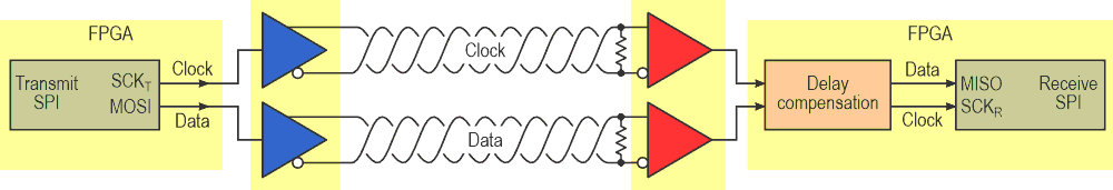

Synchronous interfaces consist of two data links, one for the synchronizing clock and one for the actual data channel (Fig. 2). To ensure proper data communication, the signal timing between both channels must be accurate to prevent bit errors at the receiving end. Thus, the overall propagation delay is less important than the delay skew between the two channels.
Transceiver and cable delay-skew of multi-pair UTP require prop-delay compensation when operating across long distances. For long cable runs, system manufacturers often recommend cost-intensive, high-quality cables.
Figure 2. Transceiver and cable delay-skew of multi-pair UTP require prop-delay compensation when operating across long distances.

Depending on the signal data rate, the cable length and the transceiver timing performance, the skew between clock and data channel must be eliminated. Typically, this is accomplished through propagation delay compensation at the receiving end. Here, FPGAs include hardware-coded algorithms that measure the time difference between the first arriving signal (either clock or data) and the later arriving one. For this purpose, the implemented logic often uses a sampling clock that is eight times the transmission clock, which in turn is twice the actual data rate.
When considering sending a 5-Mbit/s data stream across a data link, the transmission clock is 10 Mbits/s or 5 MHz, while the oversampling clock in the FPGA is 40 MHz. To keep the delay compensation limited to one transmission clock cycle and, thus, relatively simple, the combination of signaling rate and transceiver and cable performance is important. Hence, at significantly higher data rates the use of high-quality cable with minimum skew is often advised.

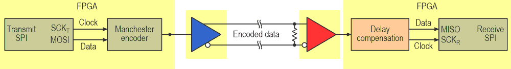

To prevent unequal charges and discharges, encode the data signal into a clock-like data stream. A commonly applied coding scheme in RS-485 applications is Manchester coding.
The simplest Manchester encoder design is an XOR-gate connected to a serial peripheral interface (SPI) port. Low-to-high and high-to-low transitions at the encoder output represent high and low bits on the data line, while long bit streams of equal polarity are converted into clock cycles. The encoded signal is applied to the driver input and transmitted across the data link. Decoding happens at the receiver output. While the decoder logic is a little more complex, it is easily implemented into an FPGA (Fig. 3).
Manchester coding in combination with transceivers using receiver equalization simplifies a high-speed data link to only one channel using standard UTP cable.
Figure 3. Manchester coding in combination with transceivers using receiver equalization simplifies a high-speed data link to only one channel

Figure 4 compares the signaling-rate versus line-length characteristics of transceivers with receiver equalization with the characteristic of a conventional EIA-485 transceiver. Device a can transmit at 10 Mbits/s across 250 m of cable. By pushing the limits to allow for some minor jitter, even 300 m can be achieved easily. Device b, however, can drive data at a lower rate of 5 Mbits/s over more than 500 m, almost twice that distance.
Transceivers with receiver equalization boost the high-frequency content of the signal, extending the reach of the data link to longer distances and at higher data rates.
Figure 4. Transceivers with receiver equalization boost the high-frequency content of the signal,
Therefore, combining Manchester coding with receiver equalization yields a cost-saving, single-channel, asynchronous data link. Unlike its synchronous counterpart, it neither requires a separate clock channel nor specific cable quality to ensure reliable data transmission.
