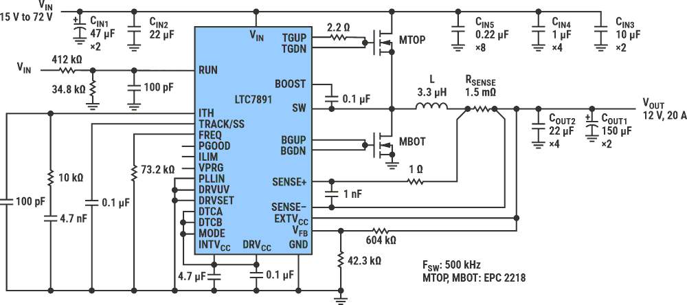

Figure 1 shows a 12 V step-down converter based on the LTC7891 synchronous controller driving 100 V GaN FETs. Operating at 500 kHz, it achieves 97% efficiency with a 20 A load and 48 V input. This is about 2% higher efficiency – 40% less power loss – than with current generation 100 V silicon FETs. To match this performance with silicon, the switching frequency would need to be less than half, requiring a larger inductor and overall solution size. This device is part of the new family of controllers specifically designed to meet GaN’s gate drive and switching requirements without the need for additional components. Analog Devices’ portfolio of GaN-optimized controllers also includes the LTC7890, a 100 V dual-channel buck controller, along with the LTC7893 and LTC7892, which serve as 100 V boost and dual-channel boost controllers, respectively.

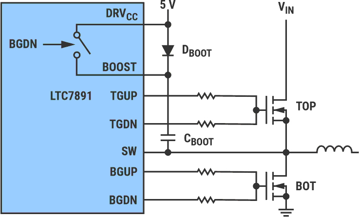

In Figure 2, a bootstrap capacitor and diode (CBOOT and DBOOT) implement a traditional high-side gate drive supply. When the high-side (TOP) switch turns off, the switch node pulls low – either due to the inductor current or the low-side (BOT) switch turning on. With both switches off, the switch node’s voltage is limited to approximately 1 V below ground by the silicon FET’s body diode. In contrast, GaN FETs conduct in the reverse direction, performing like a 2 V to 3 V body diode. When using a bootstrap diode, the negative switch voltage adds to the bootstrap capacitor’s voltage, increasing the high-side FET’s gate-source voltage. Alternatively, a smart switch can prevent the driver from overcharging without the need for extra clamping diodes. This active switch turns on after the BOT gate is on, resulting in a regulated high-side gate drive voltage that does not depend on the body diode drop. In the case of extended dead times, these controllers tolerate negative spikes on the switch node. With a stable high-side driver supply established, the next step is accurately measuring the high-side FET’s gate-source voltage.

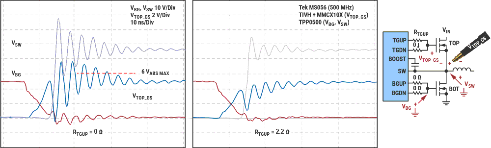

Figure 3 shows the gate and switch waveforms of a GaN-based step-down (buck) converter. Without a series gate turn-on resistor, the TOP FET’s gate-source voltage (VTOP_GS) exceeds the GaN FET’s specified +6 V maximum gate-source voltage rating. Adding a 2.2 Ω TGUP resistor reduces VTOP_GS and dampens gate and switch node ringing. High impedance oscilloscope probes capture the ground-referenced low-side gate (VBG) and switch node (VSW) waveforms. The TOP FET’s source (VSW) alternates between VIN and ground. The GaN’s high slew rate (over 30 V/ns) and 300 MHz ringing exceed the practical common-mode limit of differential probes typically used to make VTOP_GS measurements. Fortunately, available optically isolated probes make this measurement possible. These probes, pioneered by Tektronix’s IsoVu technology, feature unbelievably high frequency common-mode rejection ratio (CMRR) and are priced accordingly.

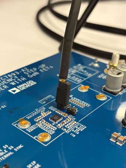

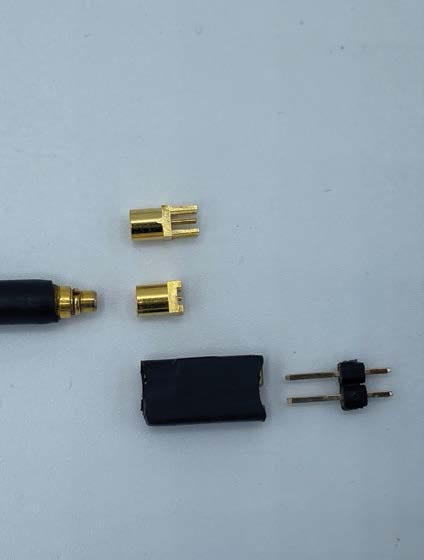

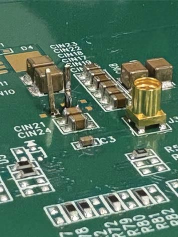

Figure 4 shows an isolated probe in action. This type of probe connects to the oscilloscope through fiber optic cables, which not only provides galvanic isolation but also keeps common-mode input capacitance low. The probe’s attenuator tip plugs directly into an MMCX connector. The probe can also connect to PCB test points using header pins and an MMCX-to-square-pin adapter. To maintain the probe’s full performance, the connection between the probe tip and the PCB is kept as short and well-shielded as possible. A board-mounted MMCX connector offers the best coaxial connection, but make sure to route short Kelvin traces from the FET gate and source. While the isolated probe may be the best – and only – way to measure high-side GaN gate voltages, let’s see how another common method stacks up.
Isolated probe setups. Isolated probe setups.
Figure 4. Isolated probe setups.

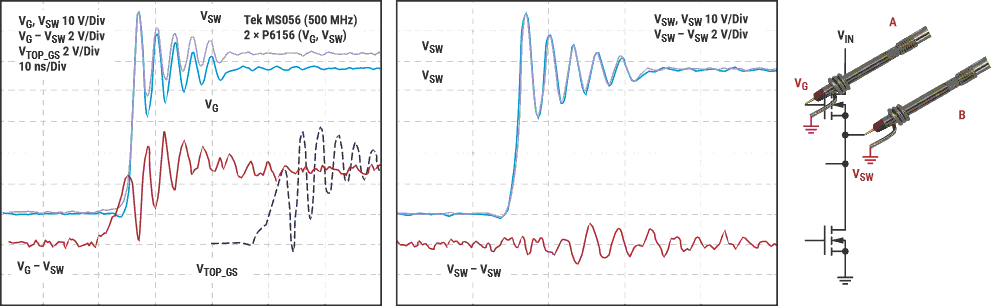

High-side gate signals can be measured with two ground-referenced passive probes, a digital oscilloscope, and math. This A – B or pseudo differential technique [1] remains popular for evaluating gate timing on low voltage DC-to-DC converters, even though it suffers from limited voltage range and CMRR. Before taking high-side gate measurements, it’s best to do a quick common-mode rejection check. Connect both the probes to the same high dv/dt voltage, deskew the timing, subtract one channel from the other, and observe the remaining signal. If the CMRR is adequate, only a small residual voltage should be seen – much less than the actual gate signal. Probe loading is another key factor. Ideally, probing should not affect circuit operation or waveforms. Standard high impedance passive probes have an input impedance of 10 MΩ in parallel with 3.9 pF to 10 pF. In contrast, isolated probes have a lower capacitance (under 2 pF) to ground. There are also less common, low impedance (500 Ω to 5 kΩ) passive probes*) that offer low capacitance, which can be helpful in these measurements.
Results

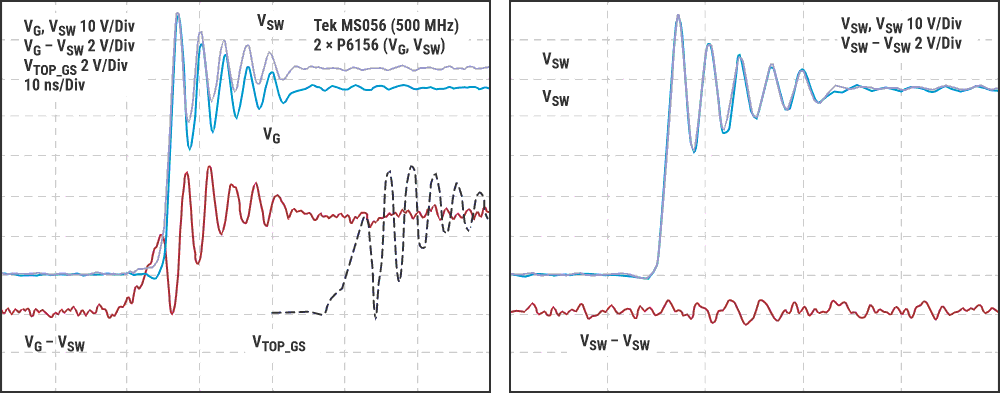

Figure 5 compares the VG – VSW waveform, captured using the A – B method, to the VTOP_GS measurement from the earlier Figure 3 isolated probe setup (shown as a dashed line). For this test, low impedance passive probes (5 kΩ || < 2 pF) were selected because higher capacitance probes (≥3.9 pF) caused a noticeable decrease in VSW’s peak amplitude, indicating probe loading. The gate waveforms are a reasonable match, though the A – B method shows a 2.7 V peak-to-peak residual common-mode signal – high compared to the 7 V peak-to-peak VG – VSW signal. High impedance passive probes showed similar levels of residual common-mode noise, but the measured VG – VSW peaks were 17% to 30% lower, likely due to loading, matching, and response issues.
TOP FET gate measurement (VG - VSW) using A - B method.
Figure 5. TOP FET gate measurement (VG – VSW) using A – B method.
In Figure 6, VG and VSW were captured using a single passive probe in two steps. With this method, the VG waveform is captured and saved in memory. The same probe is then moved and used to capture VSW. Note that a second probe, connected to VSW, triggers the oscilloscope during both measurements. Channel math is used to recall and subtract the waveforms. This approach adds an extra step but improves common-mode rejection by avoiding probe mismatches. While high impedance passive probes performed better than expected, the low impedance probes provided results that more closely matched those of the trusted isolated probe, making them the preferred choice in this case.
TOP FET gate measurement (VG - VSW) using one probe.
Figure 6. TOP FET gate measurement (VG – VSW) using one probe.
