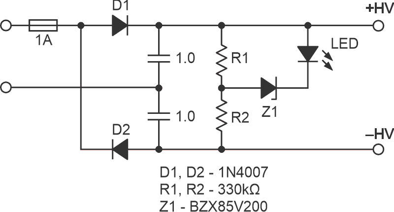

The gadget also promised protection from surges up to 2000 Volts (the normal AC voltage is 220 V here where I live). This protection was its main merit, so of course I had to check this feature as well. I did so with the simple circuit shown in Figure 1.
This simple circuit supports confirmation of valid (or not) surge voltage protection.
Figure 1. This simple circuit supports confirmation of valid (or not)
The circuit produces a DC voltage of roughly double the input AC amplitude, approximately 600 V in this case. The DC output shouldn’t be considered a shortcoming! The values of resistors R1 and R2, and diode Z1 (a 200 V Zener diode in this case) need to be recalculated if your AC outlet voltage isn’t 220 V.
The circuit also includes a LED which will illuminate only when this doubled voltage really is present on the gadget’s output. The LED should be bright enough for a current of ~ 1 mA or less. Should I warn you here to beware of high voltage; to be cautious and not to connect any inappropriate load to the circuit? That said, I’ll continue the story.
I connected an AC/DC voltmeter to the output of the “Extension Lead with Surge Protection”, while its input was connected to the output of the circuit. The voltmeter showed 600+ volts! The gadget was simply translating its input to the output without any high voltage detection, far from protection.
