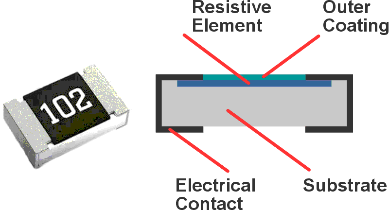

Please visualize the structure of a surface mount resistor as shown in the Figure 1.
Surface mount resistor constituents include this writeup's showcase electrical contacts.
Figure 1. Surface mount resistor constituents include this writeup’s
Normally this part would be installed on a circuit board with the outer coating visible for inspection and with the substrate adjacent to the circuit board’s surface. However, if the circuit board’s goodies are operating at microwave frequencies, this might not be the best idea.
