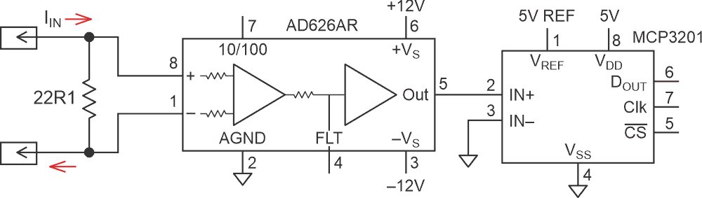

Let's now change the data flow and look at an ADC, as shown in Figure 3. A 0-20 mA current loop is a rare variation of the 4-20 mA current loop, but I want to use it to make a point. Because it is possible to connect several receivers in series in the current loop, you want the volt drop in your receiver to be low and allow for floating input. Otherwise, it would be simple to connect a 250 Ω resistor to ground. Let's choose an input resistor of 22.1 Ω, so that the maximum voltage drop is 442 mV. The instrument amplifier has a gain of 10, so we get to 4.42 V.
Circuit to convert a 0-20 mA loop to a 0-5 V input ADC via an instrumentation amplifier.
Figure 3. Circuit to convert a 0-20 mA loop to a 0-5 V input ADC via an instrumentation amplifier.
I will choose to calibrate at 0 mA and 20 mA. The lower range is not chosen coincidentally – a judicious selection can simplify the calculation (my point from above), as you will see. The calibration procedure injects no current (i = 0 mA), and the associated ADC reading N1 is learned. The calibrator is changed to i = 20 mA, and the upper reading is taken and saved as N2. Going back to Equation 2 again:
  (6)
As I said, a choice of zero will simplify this to:
  (7)
And finally,
  (8)
When the ADC performs its conversion, the current (i) can simply be calculated. Again, multiplying all the numerators before working on the denominator normally allows me to stay with integer arithmetic, especially if I scale the readings appropriately. For instance, instead of working with 20 mA, I could express it as 20,000 μA or some intermediate scale.
