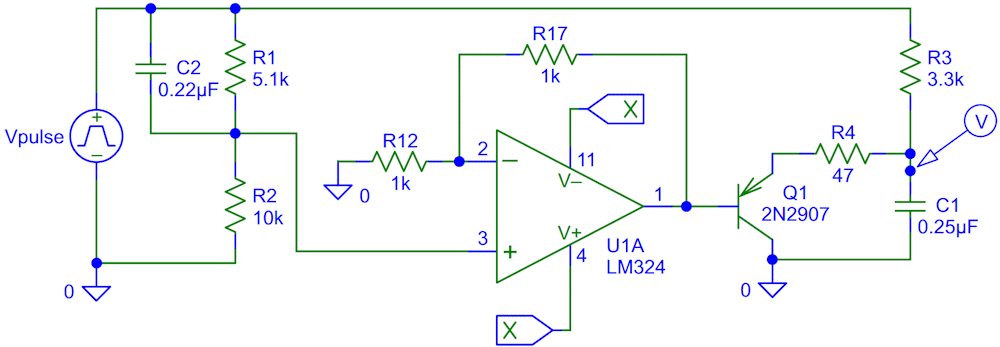

Simplification using an op amp
One way to simplify is to use the same input voltage level as the output, which precludes requiring an input isolation circuit. See Figure 1 for an example.
This simplified derivative-controlled low pass filter has its output at V.
Figure 1. This simplified derivative-controlled low pass filter has its output at V.
Starting with the circuit in Reference 1 as a foundation, the simplified circuit requires an R1C2 combination to act as the derivative function. The input signal requires a filter, R3C1 as the filter time constant. This derivative signal should be wired to a transistor switch, Q1, a 2N2907A, which discharges that capacitor at a faster rate, R4C1. A non inverting amplifier, ¼ of an LM324N, acts to provide isolation of the derivative input to the transistor switch. This is accomplished by ensuring that the Q1 emitter to base junction is zero, therefore not conducting at steady state.

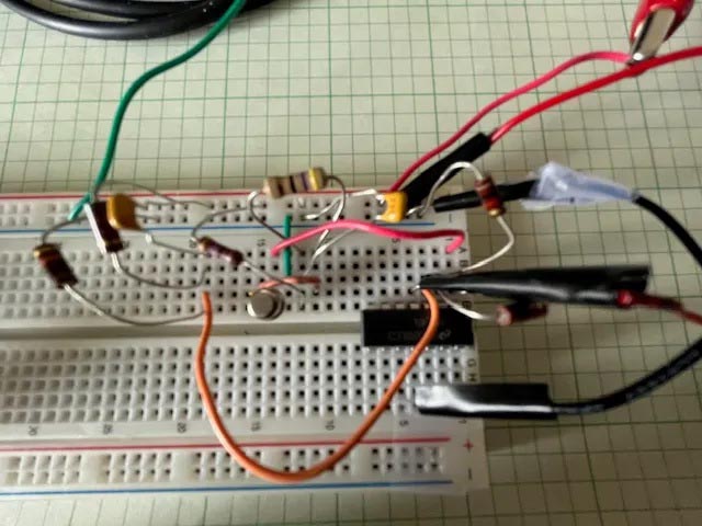

Figures 2-4 show the actual circuit being tested, and the results.
The circuit in this Design Idea was breadboarded and lab-tested, not just simulated.
Figure 2. The circuit in this Design Idea was breadboarded and lab-tested, not just simulated.

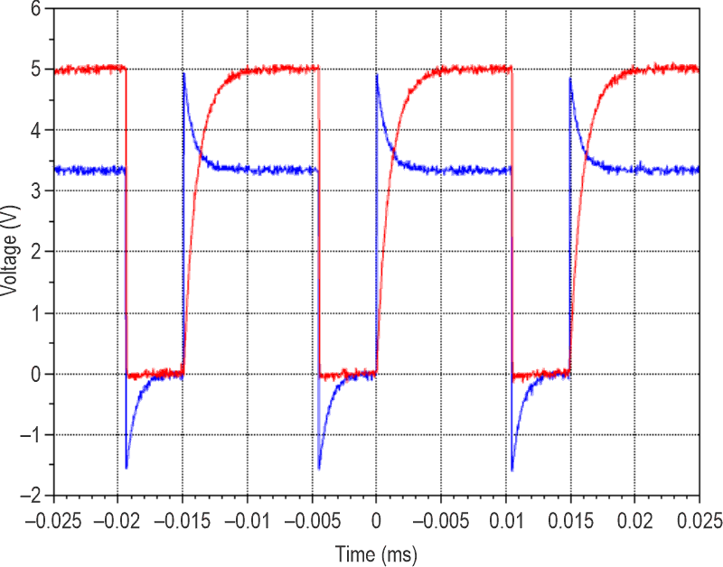

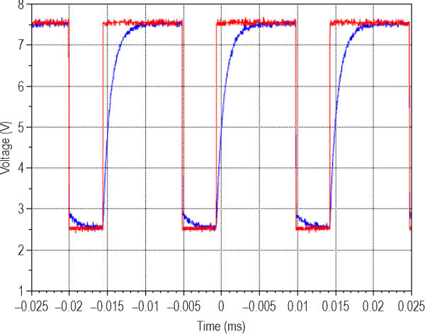

In this graph of test results, the red trace is the input, with the output at C1 in blue. Note that the output is at the same level as the input, but the time constants are different.
Figure 3. In this graph of test results, the red trace is the input, with the output

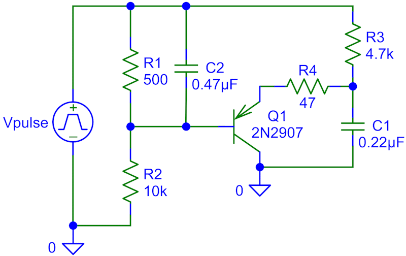

Further simplification
Removing the op amp is possible if the emitter to base junction is biased below the cut-in voltage. Reference 2 has an extensive discussion on the subject, based on the Shockley diode equation. The emitter base junction is the diode in question. There is a point where the forward bias current quite low, assumed to be 1% of the maximum load current. The voltage at that point is considered to be the cut-in voltage; for silicon devices it is assumed to be 0.6 V.
For this application, R1 is lowered to 500 Ω, which results in a 0.238 V difference across the forward-biased Q1 junction, below the cut-in voltage at steady state.
This schematic shows a further simplification of the previous circuit.
Figure 5. This schematic shows a further simplification of the previous circuit.
Figures 5-7 show the simplified circuit being tested, and the results.

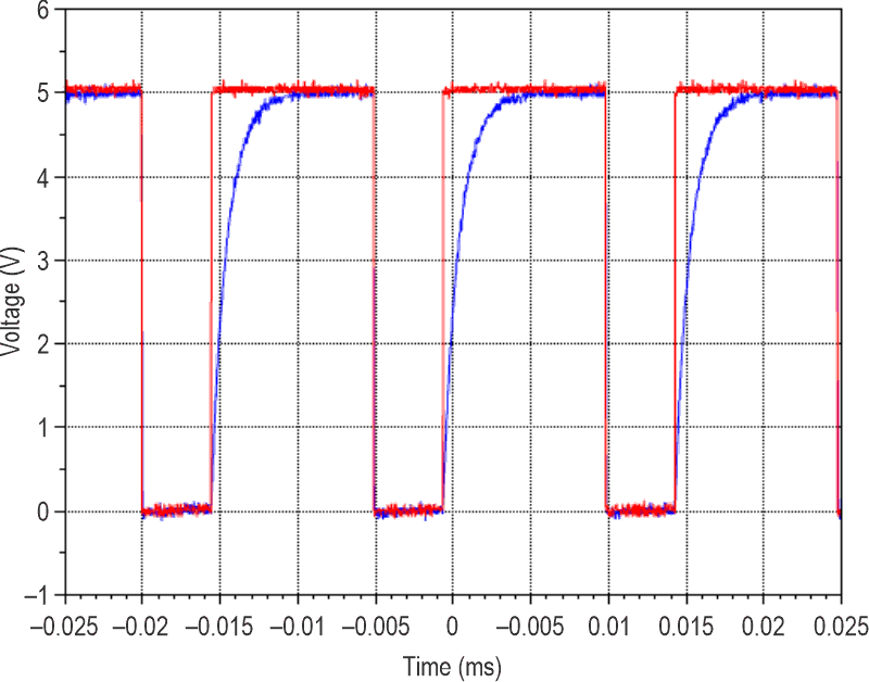

In this graph of test results for the further simplified version of the circuit, the red trace is again the input, with the output at C1 in blue.
Figure 6. In this graph of test results for the further simplified version of the circuit,

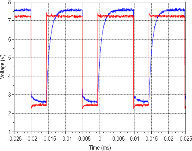

Conversely, in this graph of test results for the further simplified version of the circuit, the red trace shows the voltage across R1, with the blue trace referencing the C1 voltage. Note the voltage difference in this case.
Figure 7. Conversely, in this graph of test results for the further simplified version of the circuit,
