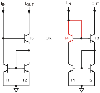

Wilson current mirror. T4 …
Wilson current mirror. T4 is optional but improves accuracy and dynamic range

Figure 3. Wilson current mirror. T4 is optional but improves accuracy and dynamic range
