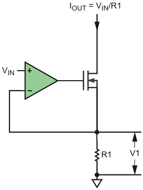

Transconductance amplifier. V
IN
IN
-> I
OUT
James Bryant
Current-Output Circuit Techniques Add Versatility to Your Analog Toolbox
Figure 4
11 Kb

Figure 4. Transconductance amplifier. V
IN
-> I
OUT
