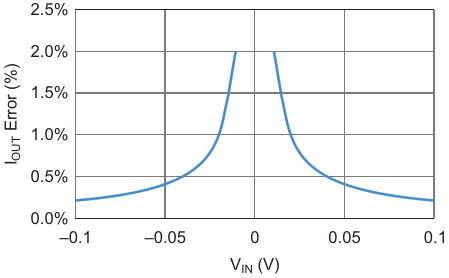

Output error of the circuit in Figure 3 plotted over a range of ±10 mA

Figure 4. Output error of the circuit in Figure 3 plotted over a range of ±10 mA
