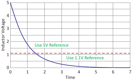

Adaptive resolution for ADCs

Figure 1. Sample inductor voltage versus time curve for a circuit measuring the voltage across an inductor when a DC step voltage is applied through a series resistor. Note the flat slope after 3 seconds, which will increase the relative error of the measurement

Figure 3. This code continuously reads the ADC connected to analog pin A0. If A0 voltage < 1.1 V, the ADC reference is switched to 1.1 V. If A0 > 1.1 V, the ADC reference is switched to V
