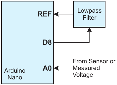

Using the Arduino Nano's PWM output and a lowpass filter to obtain the desired DC signal to use as a voltage reference

Figure 5. Using the Arduino Nano's PWM output and a lowpass filter to obtain the desired DC signal to use as a voltage reference
