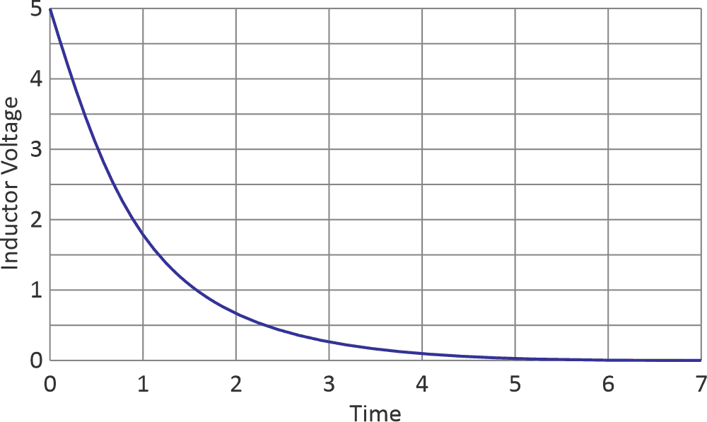

What if we were designing a device to measure the voltage across an inductor when a DC step voltage is applied through a series resistor? You can see in the curve in Figure 1, in the first couple of seconds we probably would get decent data point readings, but after that, many of the data points would have the same value since the slope is shallow. In other words, the relative error would be high.
Sample inductor voltage versus time curve for a circuit measuring the voltage across an inductor when a DC step voltage is applied through a series resistor. Note the flat slope after 3 seconds, which will increase the relative error of the measurement.
Figure 1. Sample inductor voltage versus time curve for a circuit measuring the voltage across an

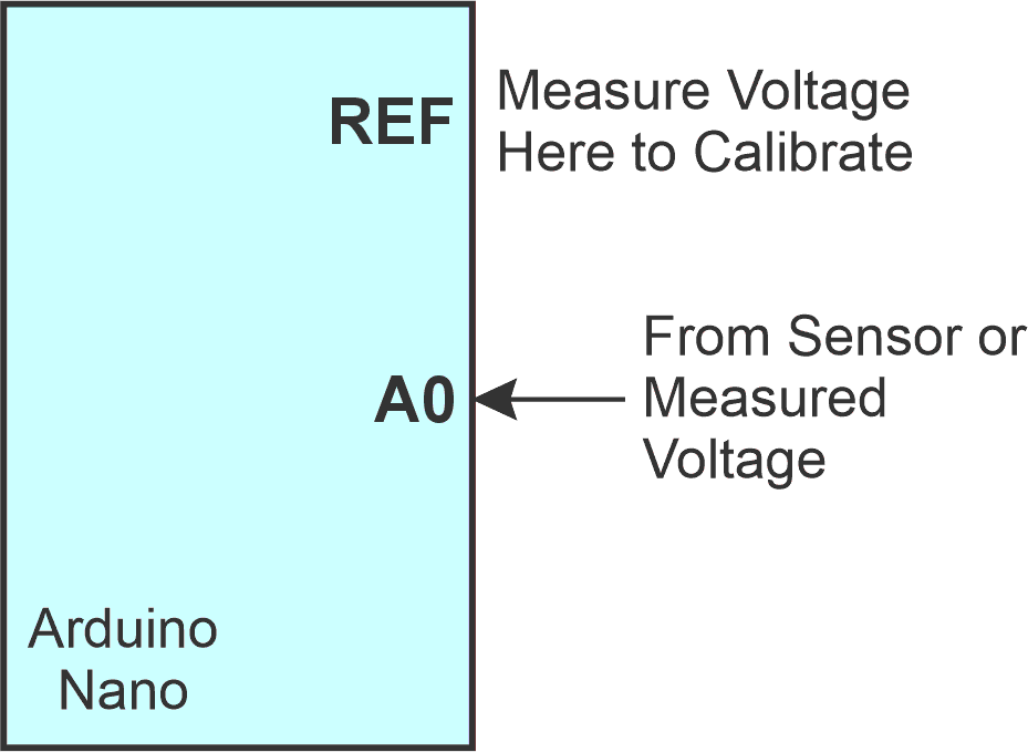

This code continuously reads the ADC connected to analog pin A0. It starts by using VCC (~5 V) as the reference for the ADC. If the reading is less than 1.1 V, the ADC reference is switched to the 1.1-V internal reference. This reference is continued to be used until the ADC returns its maximum binary value of 1023, which means the A0 voltage must be 1.1 V or greater. So, in this case, the reference is switched to VCC again. After taking a valid voltage reading, the code prints the reference value used along with the reading.
The 5 V and 1.1 V references must be calibrated before use to get accurate readings. This should be done using a reasonably good voltmeter (I used a calibrated 5½ digit meter). These measured voltages can then be entered into the code.
Note that towards the top of the code, the 5-V reference voltage variable (“referenceVoltage5V”) is set to the actual voltage as measured on the REF pin of the Arduino Nano, when the input on A0 is greater than 1.1 V. The 1.1-V reference voltage variable (“referenceVoltage1p1V”) should also be set by measuring the voltage on the REF pin when the A0 voltage is less than 1.1 V. Figure 3 illustrates this concept.
This code continuously reads the ADC connected to analog pin A0. If A0 voltage < 1.1 V, the ADC reference is switched to 1.1 V. If A0 > 1.1 V, the ADC reference is switched to VCC.

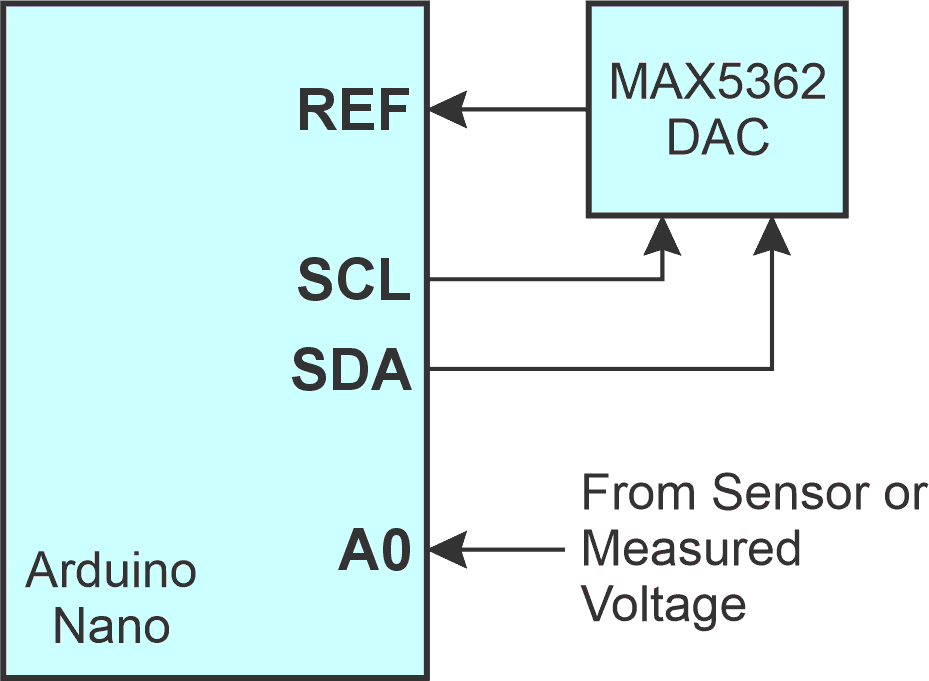

If needed, this concept could be expanded to add more levels of reference, although I wouldn’t go more than 3 or 4 levels on a 10-bit ADC due to diminishing returns. The following are a few examples of how this could be done.
The first uses a DAC with its own reference tied to the Nano’s REF pin. The DAC controlled by the Nano could then be adjusted to give any number of reference values. An example of such a DAC is the MAX5362 DAC with I2C control (although its internal reference is 0.9×VCC, so the max reading would be roughly 4.5 V). In this design, the Nano’s REF pin would be set to “EXTERNAL.” See Figure 4 for more clarity.

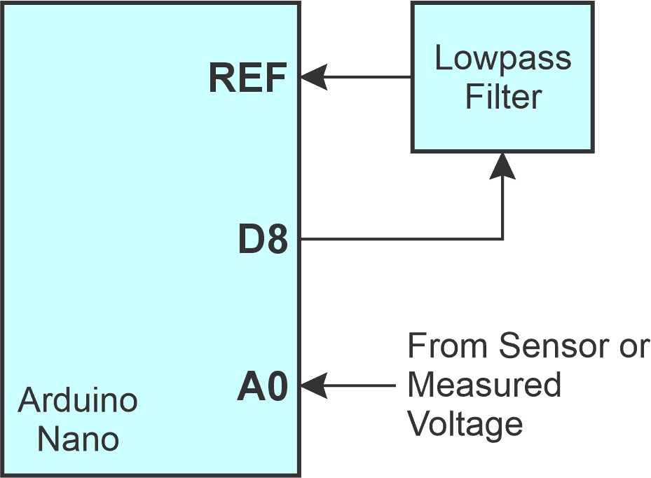

Nano’s PWM output method
Another way to create multiple reference voltages could be by using the Arduino Nano’s PWM output. This would require using a high-frequency PWM and very good filtering to obtain a nice flat DC signal, which is proportional to the 5-V reference value. You would want a ripple voltage of about 1 mV (–74 dB down) or less to get a clean, usable output. The outputs would also need to be measured to calibrate it in the code. This technique would require minimal parts but would give you many different levels of reference voltages to use. Figure 5 shows a block diagram of this concept.

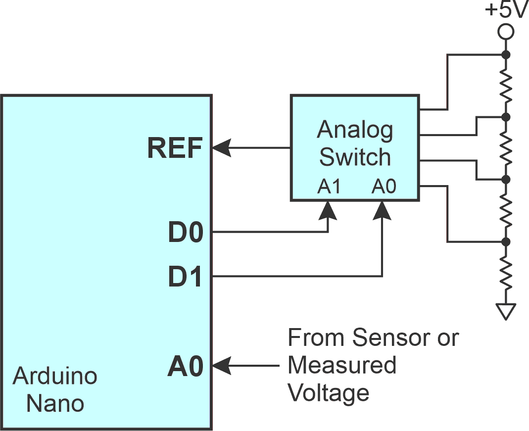

Resistor ladder method
Another possibility for an adjustable reference is using a resistor ladder and an analog switch to select different nodes in the ladder. Something like the TI TMUX1204 may be appropriate for this concept. The resistor ladder values can be selected to meet your reference requirements. Figure 6 shows that two digital outputs from the Nano are also used to select the appropriate position in the resistor ladder.
