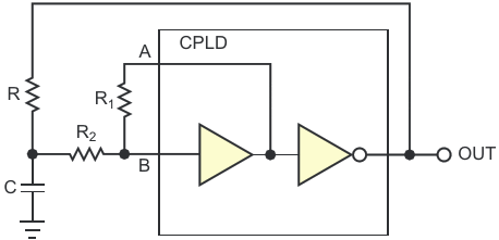

Add a resistor and capacitor to a basic Schmitt-trigger buffer to form a low-cost oscillator

Add a Schmitt-trigger function to CPLDs, FPGAs, and applications
Figure 1. Use a portion of a programmable-logic device or gate array to implement a Schmitt-trigger buffer (a) by adding either two (b) or four external resistors (c)
Figure 2. Add a resistor and capacitor to a basic Schmitt-trigger buffer to form a low-cost oscillator
