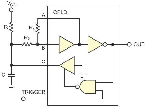

A NAND gate locks out trigger pulses, forming a nonretriggerable, monostable circuit

Figure 4. A NAND gate locks out trigger pulses, forming a nonretriggerable, monostable circuit
