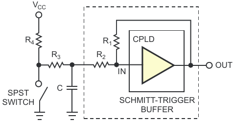

Add a Schmitt-trigger function to CPLDs, FPGAs, and applications

Figure 5. Use a Schmitt trigger to debounce switch contacts
